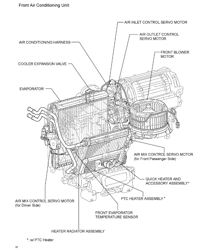

AC blowing cold on passenger side, hot on driver side
2008 TOYOTA HIGHLANDER
155,000 MILES • 6 CYL • 2WD
WSMILLER64
I have had the AC charged, didn't fix it. I replaced the under hood and under dash fuses myself and that didn't fix it. I have read that it maybe the actuator but I don't know where it is and I'm a disabled, single woman so I can't afford to carry it to the dealership. Please help point me in the right direction if this might be the problem and the steps, tools I need to fix it.
Many thanks.

Welcome to 2CarPros. That description sounds like a bad air mix door actuator for the drivers side. The door actuator on the case is on the drivers side. However replacement isn't an easy thing as the entire dash has to come out to access the part. Below is the process.

76. Remove front air mix control servo motor sub-assembly
Reverse these to reassemble the system.
What I would do first is look up above the gas pedal and see if you can see or reach that actuator before doing the above. If you can it might be possible to move the actuator enough to control the temperature without removing it for now.

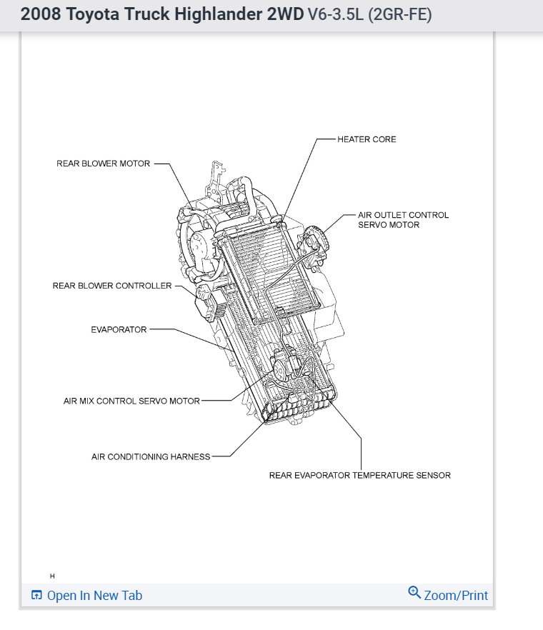

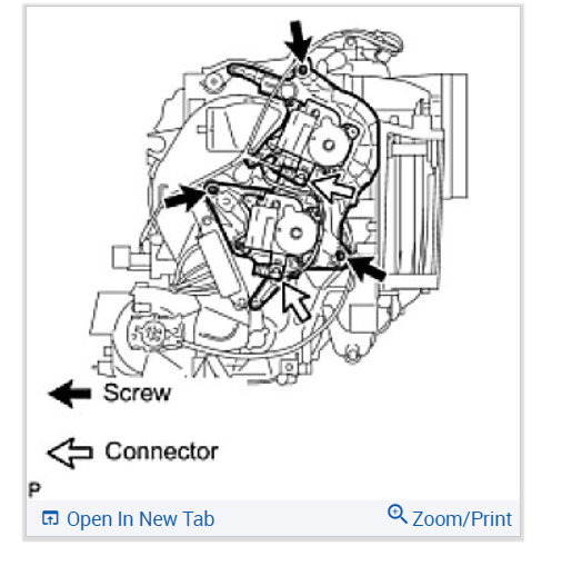

If I can jump in here. I found diagrams so you can see what you are in for when doing the job. Check out the diagrams (below). Please let us know what you find. We are interested to see what it is.
