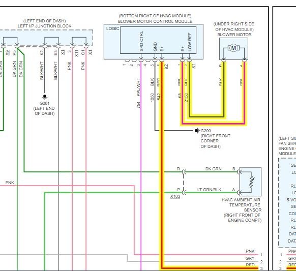

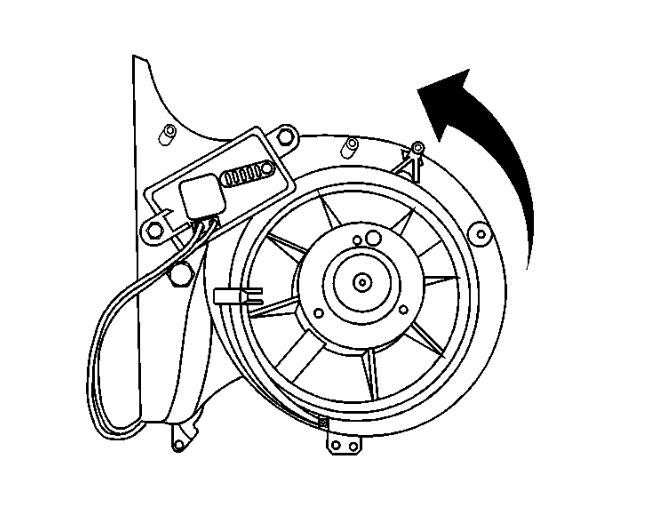

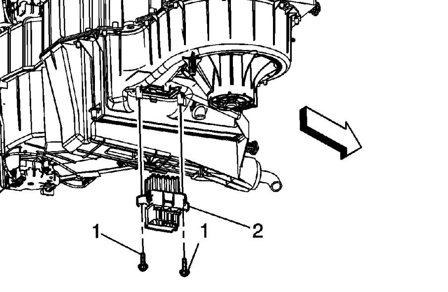

Good morning,
The blower motor is a common failure but needs to be confirmed.
https://www.2carpros.com/articles/low-or-no-air-flow-from-vents
Do you have a voltmeter or test light to do some checks?
