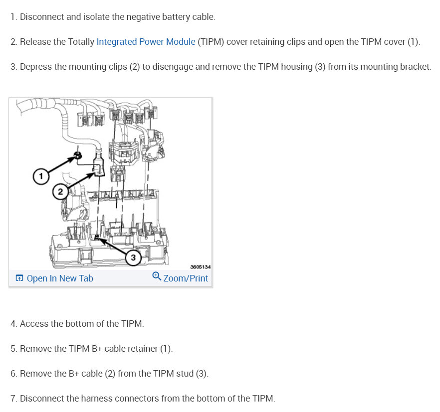

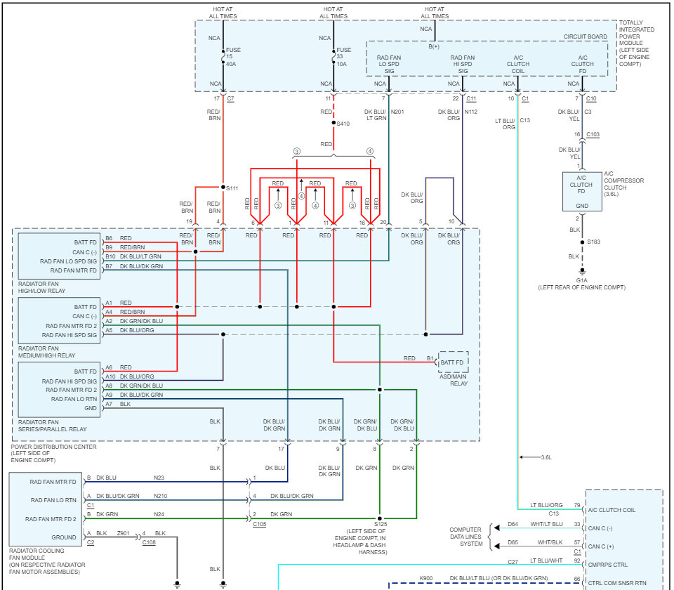

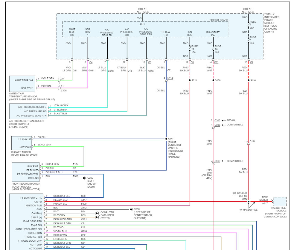

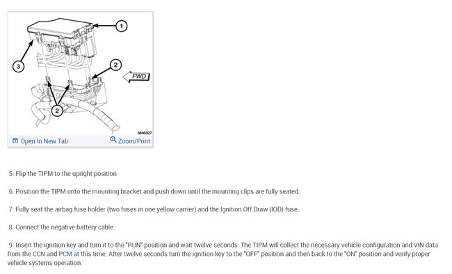

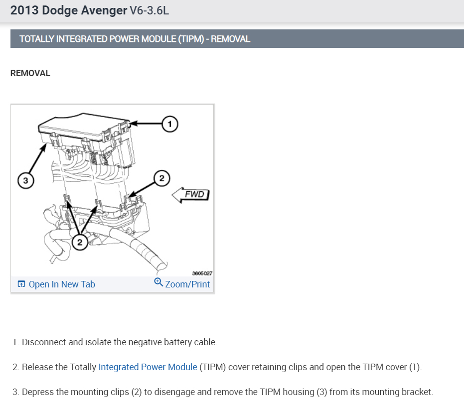

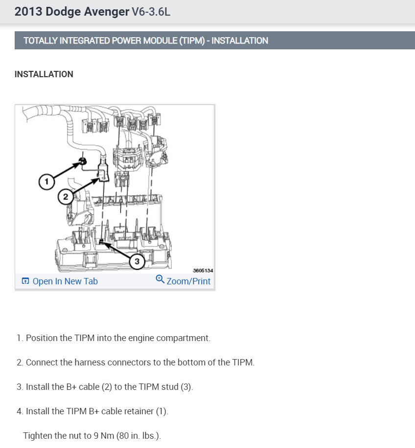

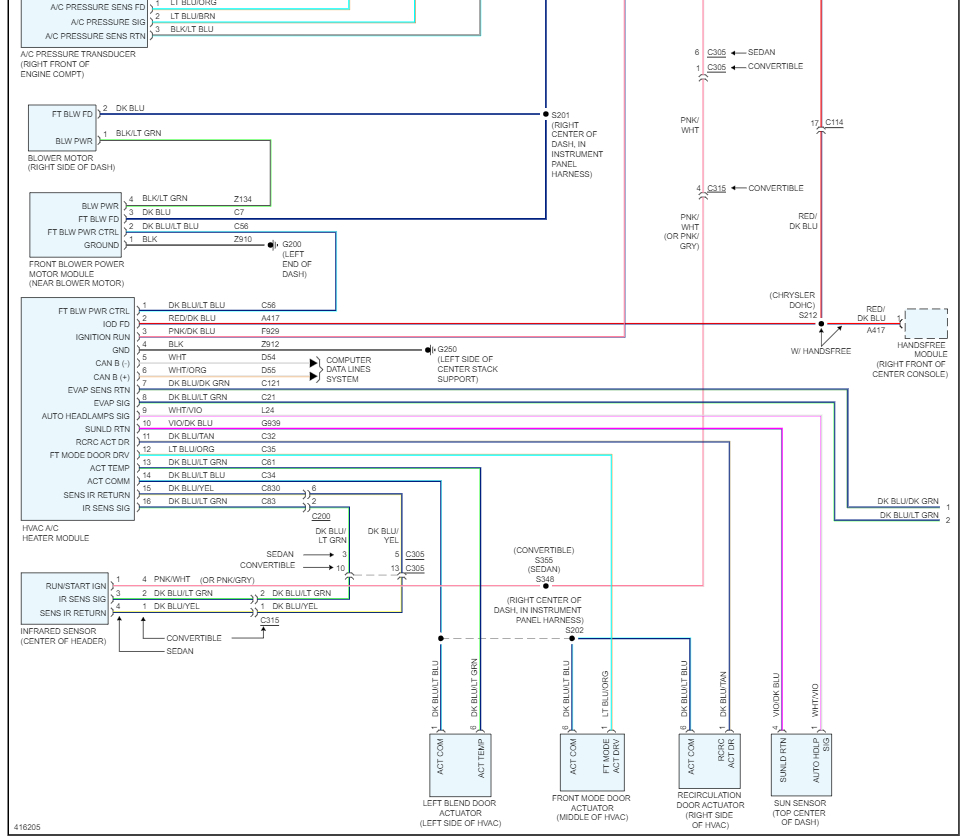

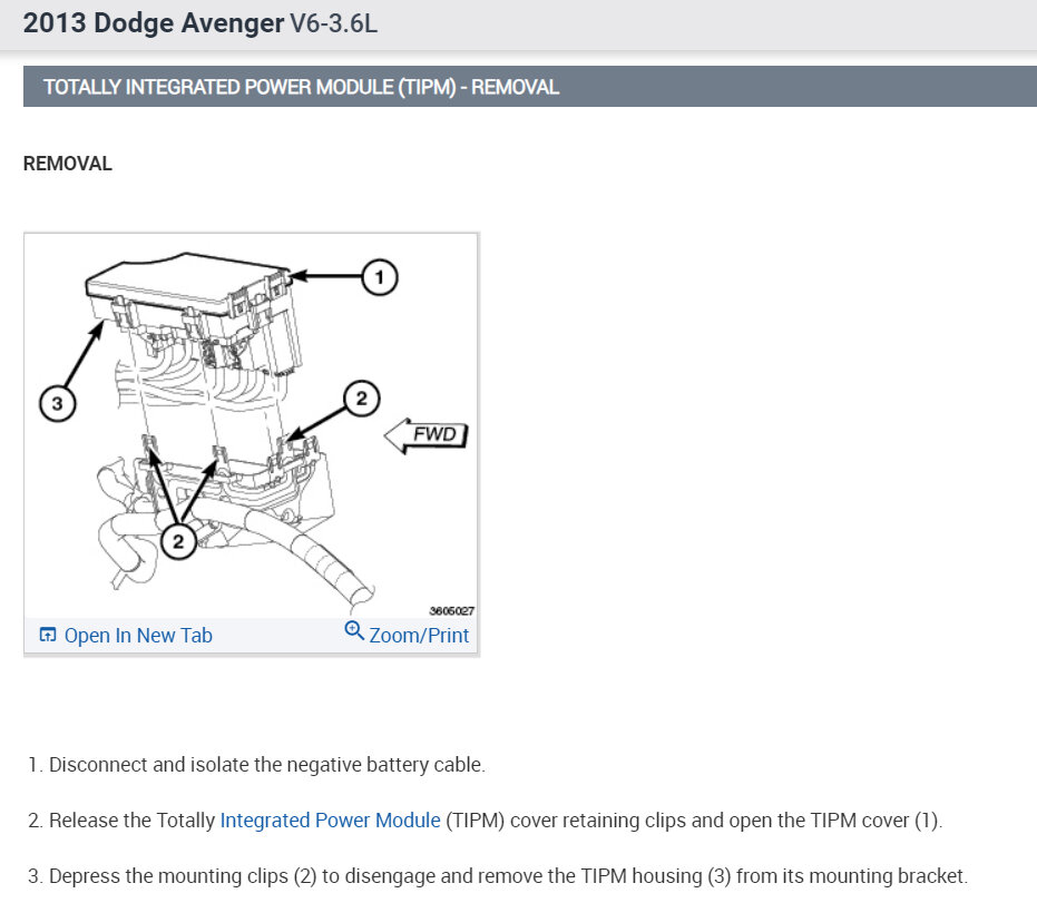

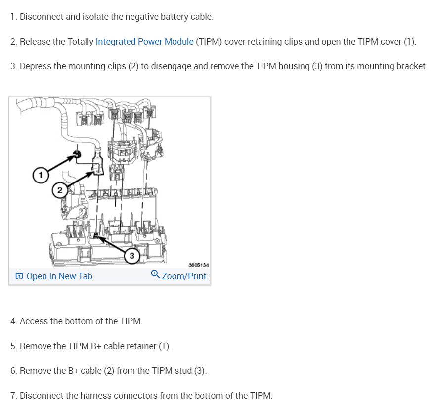

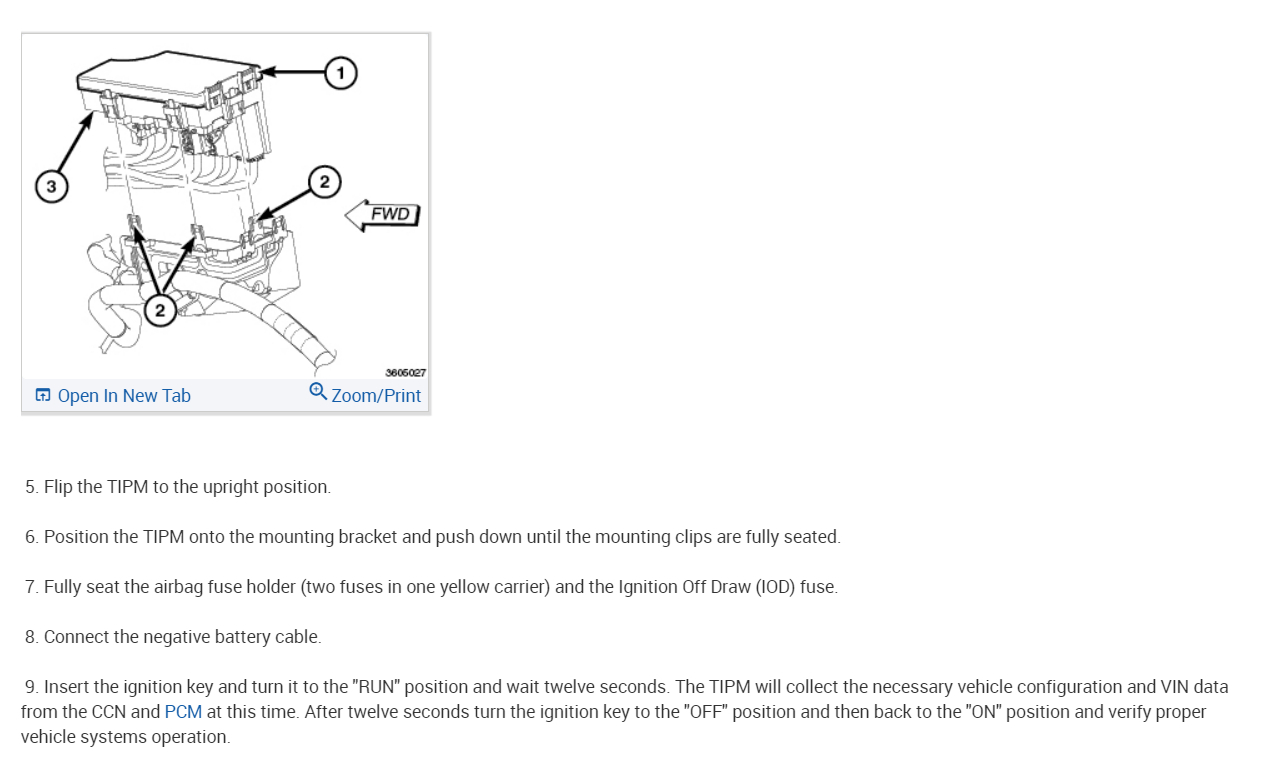

It sounds like you may have shorted out the TIPM, but I would check the fuse # 15, 23, 8 and 6 which is located on the left side of the engine compartment.
Here is a guide that will help you:
If the fuses are good here is how to change the TIPM out which is easy because it-self learns. Also, I have included the HVAC system wiring diagrams so you can see how the system works. Check out the images (below). Let us know what happens and please upload pictures or videos of the problem so we can see what's going on.
