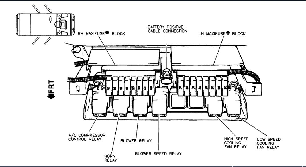

Blower is not working regardless of switch speed position. Cannot find where (exactly) the blower motor fuses and relays are in the vehicle.
Jun 10, 2020 at 8:10 AM
Experienced Mechanic
52,796 POSTS
Good afternoon,

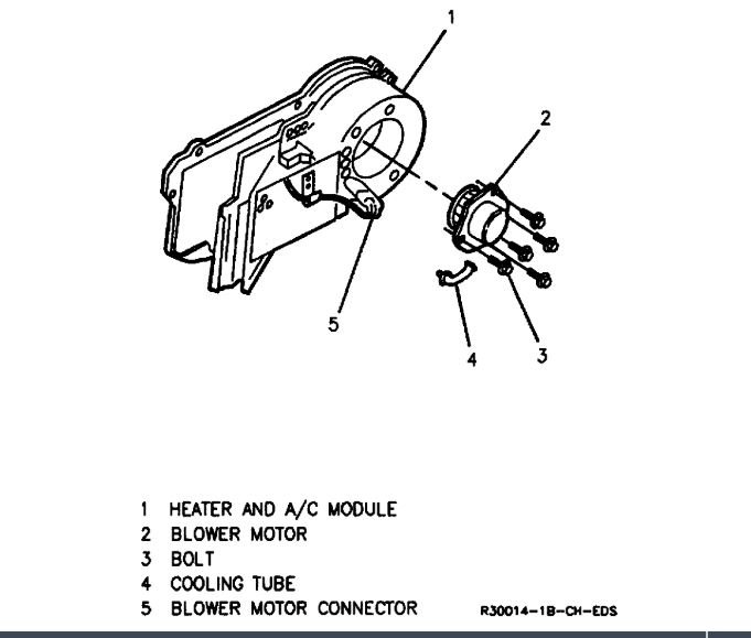

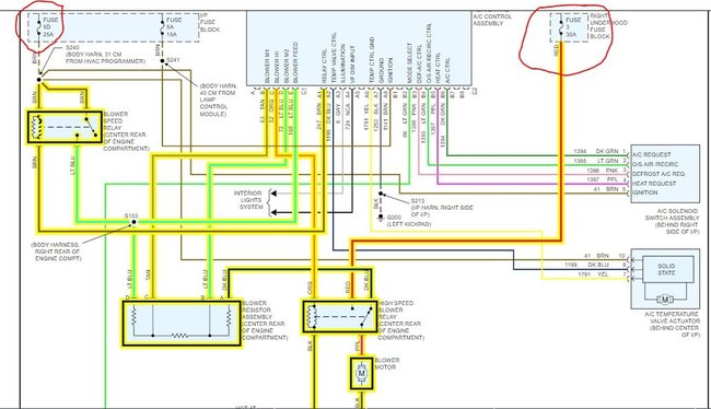

I attached the relay locations and the fuse locations to check.
If you have a test light, we can do some testing to find the failure.
https://www.2carpros.com/articles/blower-fan-motor-works-on-high-speed-only
The most common issue is the blower resistor on the heater blower box.
