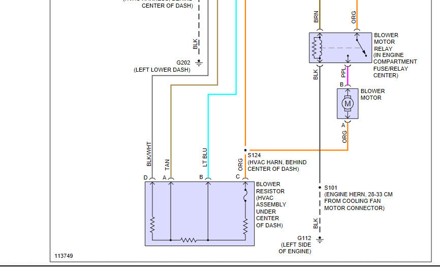

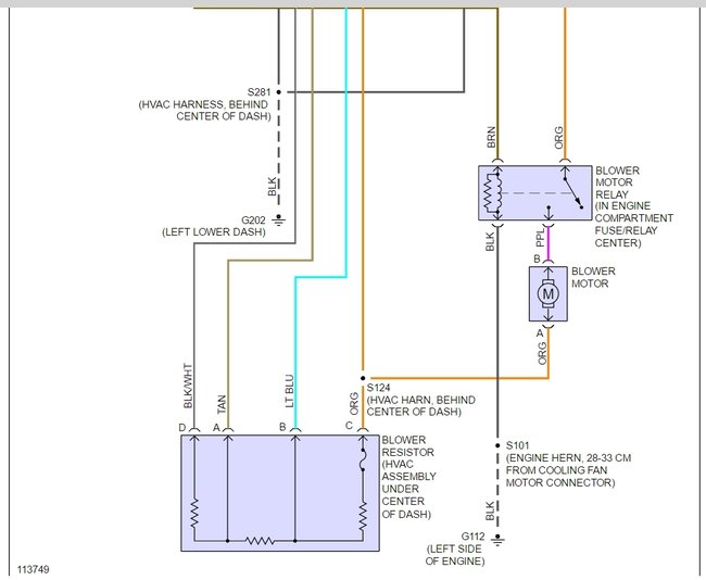

if you have power to the relay then try a like relay by switching them if blower works that is the problem, if not then you need to delve further like is the switch sending power? does blower only work on high? then it may be resistor is bad. see picture.

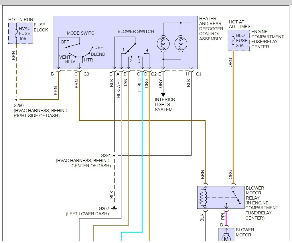

I found these wring diagrams to help troubleshoot the problem. Test the power and ground for the relay.
Here is a guide that can help you
Please let us know what you find so it will help others.
Best, Ken

I am sorry it has taken me so long to try this information you gave me. It was reviewed immediately but I have only just now tried these tests. Everything up to step 12 had been done in previous tests and when I replaced the relay. I had assumed all was well with the relay before because I can hear it activate when it is plugged in with the power turned on, but upon doing these tests I get an unexpected result and wonder how it is possible for that relay to activate at all.
I jumped terminals 85 and 86 (step 12 in the link you gave me) with the engine off and found the circuit to be active. Next I went to step 13 and attempted to jump circuits 87 and 30 with the engine running and my tester did not light up. It was not clear to me from the instructions given if the previous circuit was supposed to still be jumped, and I had not jumped it when I changed the tester light to this second circuit. With the tester light still in this circuit I attempted to jump the circuit between 85 and 86 again, and was surprised to find no arc as I closed this circuit. I changed the tester light to this circuit and found it to be dead. When I turned off the ignition I again had a hot circuit between leads 85 and 86. I don't know, but this sounds like a problem to me.
What's going on here? Is this how this side of the relay is supposed to be functioning or is there a problem somewhere in this circuit?

it may be the fuse box try tweaking the prongs of the relay then putting dielectric grease on them I t may be getting poor contact in fuse box or you will need another fuse box where relay goes if no power there. However you should have a mechanic scan for codes for a control head problem
