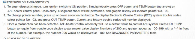

I am assuming you have not done self diagnostics which you should do it is in picture because it may not be that module. that module is by blower motor we have no picture. See picture for self diagnostics then get back with codes.
May 8, 2017 at 11:55 PM

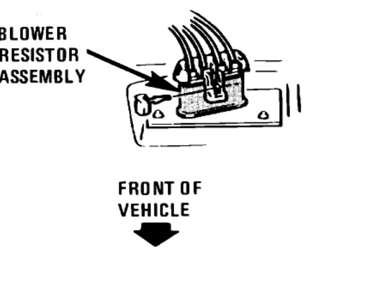

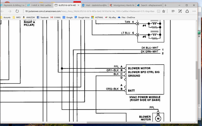

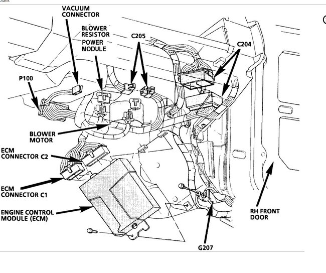

Cannot find where they hid the A/C blower module they state right of dash. can anyone help me find?
May 11, 2017 at 10:39 AM (Merged)
  • 55,859 POSTS
I find two diagrams (below) that can show different locations, one is under the dash on the passengers side while the other is under the hood on the passengers side.
Let me know if you find it.
May 11, 2017 at 10:53 AM
MELVIN MITCHON
GREAT AND I FOUND IT THANKS A BUNCH
