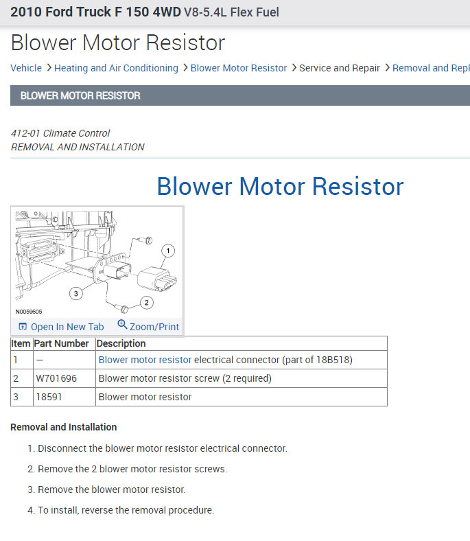

On the dash is a dial for 4 speed fan for A/C and heat. The low fan speed has stopped working. Only the 2 top fan speeds are working. I’m not sure what to check first.
Sep 2, 2021 at 10:34 AM
SQM
  • 6,383 POSTS

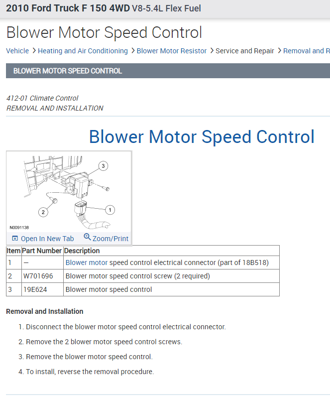

It sounds like an issue with the blower motor resistor.
That resistor can go bad and will only come on in certain speed setting.
This truck also has a blower motor speed control unit which can also trigger similar issues.
But the resistor should be checked first.
To access the resistor you will have to remove the panel below the glovebox on the passenger side.
Here is a helpful video:
https://youtu.be/VI9x3rUKVBo
I have attached diagrams for your reference
