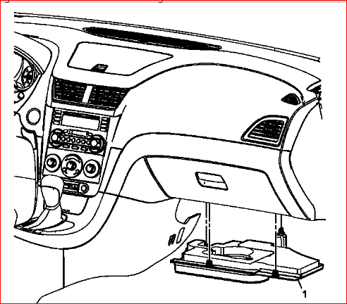

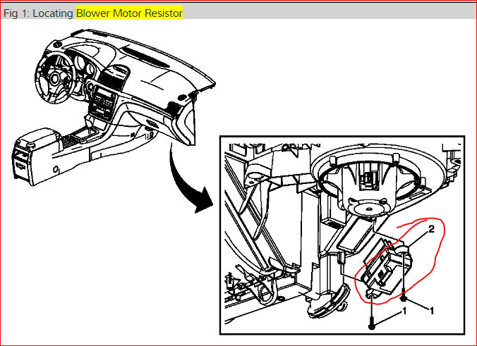

My AC blower stopped working. Comes on and off it I bang on the glove compartment sometimes it comes on.
Jul 21, 2018 at 1:20 AM
DANNY L
  • 5,648 POSTS
Hello, I am Danny.
Sounds like you are having trouble with your blower motor resistor. I am attaching two pictures of its location. You must remove the cover panel under the glove box to gain access. GM has had a few issues with the resistor connection melting. I have circled the resistor in red. Be sure to check the connection well for melting/burnt/poor connection.
This guide can help as well
https://www.2carpros.com/articles/blower-fan-motor-works-on-high-speed-only
I have done quite a few GM's! Hope this helps and feel free to ask any other questions if needed. Check out the diagrams (Below). Please let us know what happens.

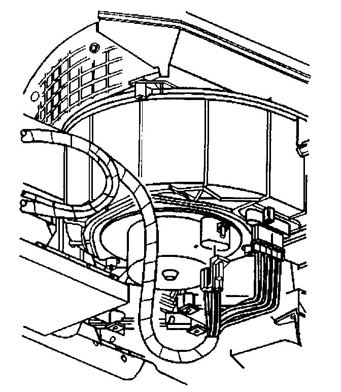

The blower motor and fan are located in the lower right hand corner of the HVAC module. Service this component as an assembly only.
picture 1
1. Remove the right side instrument panel (IP) insulator.
2. Move the Body Control Module (BCM) aside. Refer to Body Control Module Replacement in Body Control System.
3. Disconnect the blower motor electrical connector.
picture 2
4. Remove the blower motor retaining screws.
5. Remove the blower motor and fan assembly.

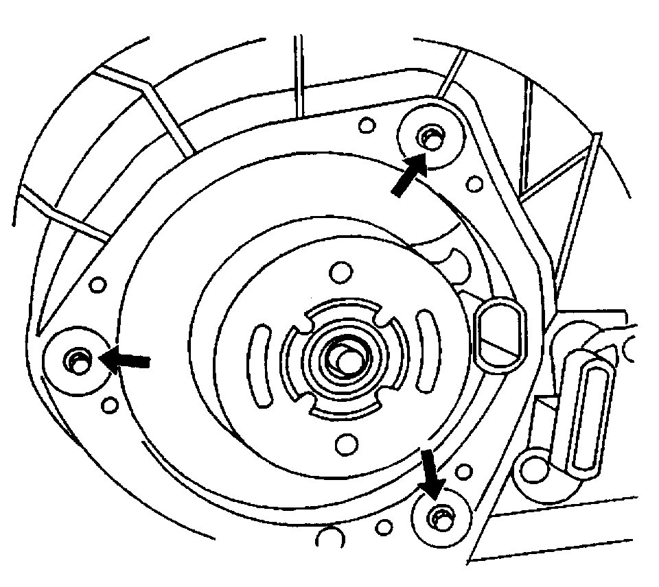

INSTALLATION PROCEDURE
picture 3
1. Install the blower motor and fan assembly.
NOTE: Refer to Fastener Notice in Service Precautions.
2. Install the retaining screws.
Tighten
Tighten the screws to 5 N.m (44 lb in).
