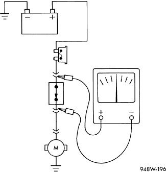

I'm not sure I completely understand. Is the blower motor slowing and then speeding back up? If that is the case, follow this voltage drop test. The attached picture correlates with these directions.
____________________
VOLTAGE DROP TEST
Theory of Operation
Voltage drop is the reduction in voltage in an electrical circuit between the source and load components. The wires and connectors of a circuit should contain next to no resistance. All the voltage should be used through the load. The "load" is the component using the power, such as a light, starter, or blower motor. If a circuit has excessive resistance, it prevents the wire from carrying sufficient current under high load conditions. A voltage drop test is an effective way to find excessive resistance in connections and circuits. To perform a voltage drop test, a Digital Volt Ohm Meter (DVOM) is used to measure the voltage drop across a live circuit or connection while it is under the load. If the circuit or connection being tested has excessive resistance, the DVOM will measure the voltage that the resistance is using. Little or no voltage drop should be read, ideally less that 0.4 of a volt, anything greater indicates excessive resistance and the circuit or connection should be inspected for cleaning or repair.
1. Turn the ignition off.
2. Use the wiring application as a guide, trace the circuit being tested and locate the components related to the circuit.
3. Set your multimeter up to check for DC voltage.
4. Carefully back probe the two component harness connectors of the circuit being tested.
WARNING: When the engine is operating, do not stand in direct line with the fan. Do not put your hands near the pulleys, belts or fan. Do not wear loose clothing. Failure to follow these instructions may result in possible serious or fatal injury.
NOTE: If you are testing the starting circuit, disable the engine so the engine does not start.
5. Crank the engine for five seconds if you are testing the starting circuit and monitor the multimeter voltage reading.
6. For circuits that don't require the engine running, turn the ignition on.
7. For circuits that require the engine running, start the engine.
NOTE: If the circuit you are checking needs to be turned on, such as Blower Motor or a lamp, do so now.
8. Monitor the voltage reading.
9. The voltmeter will show the difference in voltage between the two points.
Is the voltage less than 0.4 of a Volt?
- At this time the circuit is functioning properly. Continue to measure the voltage between the components and wiggle the wire harness and connectors while checking for an intermittent condition.
- Use the wiring application as a guide to trace the circuits and look for any in-line connectors where the excessive resistance could occur intermittently.
- Look for any chafed, pierced, pinched, or partially broken wires.
- Look for broken, bent, pushed out or corroded terminals. Verify that there is good pin to terminal contact in the related wire harness connectors.
- Perform any Technical Service Bulletins (TSBs) that may apply.
- Repair the excessive resistance in the circuit.
- Use the wiring application as a guide to trace the circuit and look for any in-line connectors where the excessive resistance may occur.

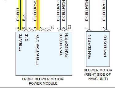

Based on your description, the first thing I would check is the blower motor relay. I have attached a picture of its location (under hood/Integrated power module) Switch the relay with another one with the same part number to see if that changes things.
Next, there is a blower motor power module under the dash that could be causing problems as well. Testing of this component requires special tooling.
Start with the relay and see if that changes anything. It may be heating up and loosing connection and then cooling enough to make connection.

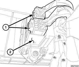

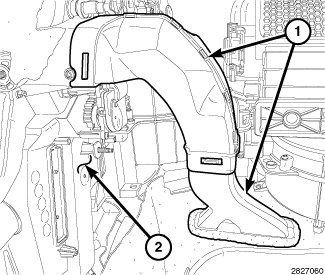

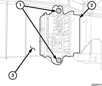

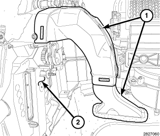

If you decide to inspect the blower motor power module, here are the directions for removal: Starting with picture 3, the remaining pics correlate with these directions.
REMOVAL
WARNING: Disable the airbag system before attempting any steering wheel, steering column or instrument panel component diagnosis or service. Disconnect and isolate the negative battery (ground) cable, then wait two minutes for the airbag system capacitor to discharge before performing further diagnosis or service. This is the only sure way to disable the airbag system. Failure to follow these instructions may result in accidental airbag deployment and possible serious or fatal injury.
WARNING: The heat sink for the blower motor power module may get very hot during normal operation. If the blower motor was turned on prior to servicing the blower motor power module, wait five minutes to allow the heat sink to cool before performing diagnosis or service. Failure to take this precaution can result in possible personal injury.
NOTE: Automatic Temperature Control (ATC) shown. Manual Temperature Control (MTC) similar.
NOTE: Illustration shown with instrument panel removed from view for clarity.
1. Disconnect and isolate the negative battery cable.
2. Remove the passenger side instrument panel silencer.
3. Disconnect the passenger side floor ducts (1) from the HVAC housing (2).
4. Disconnect the two wiring harness connectors (1) from the blower motor power module (2).
5. Remove the two screws (13) that secure the blower motor power module (2) to the HVAC housing (3).
6. Remove the blower motor power module from the HVAC housing.
