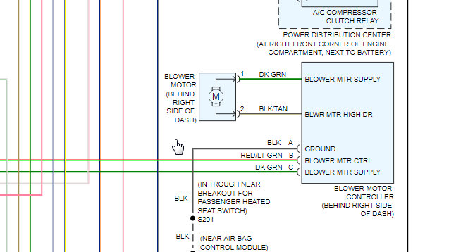

Hi, my heat/air conditioner blower motor only works on high. I have replaced the blower motor relay. The problem was fixed temporarily (like one day), but now I have the same problem. I am not sure what my next step would be. Should I look at the blower motor itself? Sounds like I should also double check the new blower relay/resistor to make sure it is not defective? Thanks for your help.
Nov 10, 2016 at 9:57 AM

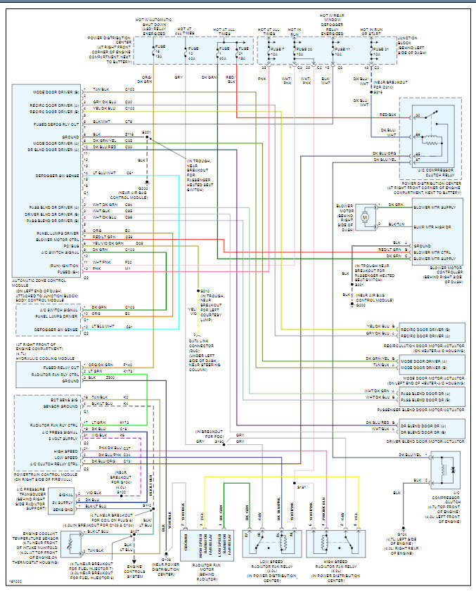

We need to suspect the blower motor controller is the issue on this type of problem. However, it could be the HVAC controller not sending the signal for the other speeds.
I am attaching the wiring diagram and we need to test the supply voltage coming into the blower motor controller. It should increase as the speed is increased.

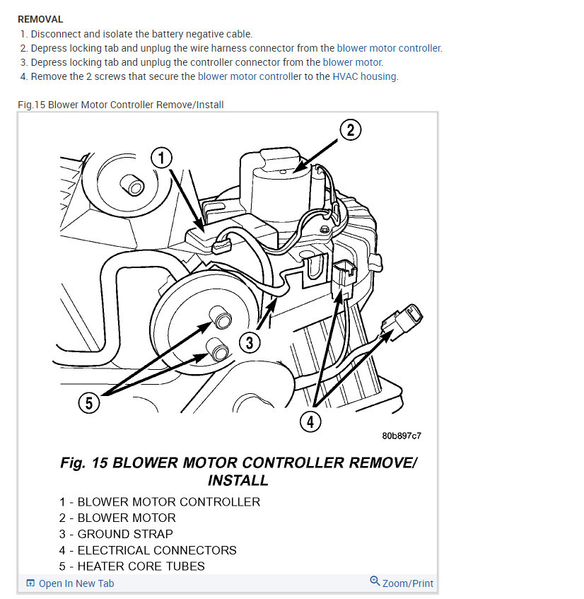

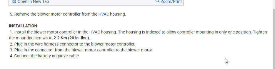

I am attaching the process on how to replace the controller which is the most likely cause but we need to do this testing and go from there.
https://www.2carpros.com/articles/low-or-no-air-flow-from-vents
Here is a guide that will help with this:
Let us know what you find and what questions you have and we can go from there. Thanks
