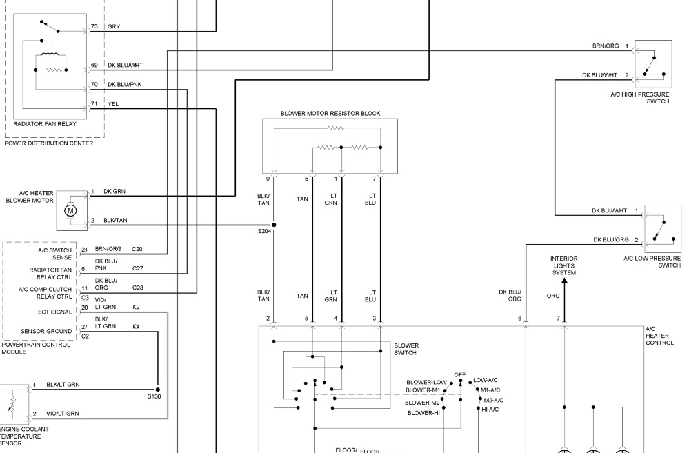

It has Freon, fuses and relay good. try to jump A/C relay and A/C clutch engage, but when i check the low pressure switch, no power .

Any applicable trouble codes? The high pressure sensor--low pressure sensor--and A/C/heater control are wired in series, part of the ground. See the PCM, A/C sensor. I believe the PCM sends voltage to the high pressure sensor first and so on. You may need to check voltage at high pressure sensor circuit, first. I am not sure how much voltage is there, use a digital multi-meter.
Others may have better ideas?

How do you know that the refrigerant level is correct? can you get high and low side pressure readings posted?
