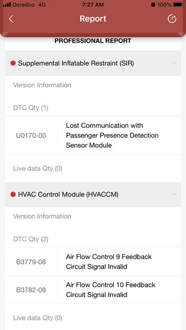

My understanding is that the air coming out from the inlet vent which supposed to sucks the air inside of the car and send to evaporator and cool’s the air and send this air out from A/C vent, some how this works in reverse like you change the electrical polarization and the fan rotating in opposite direction. i have attached the can scan report kindly look at it. thanks

Based on what you said, it does sound like the polarity is being reversed.
I looked up the codes, and both require me to know if this has automatic climate control or manual control.
Sorry about that. Could you let me know?

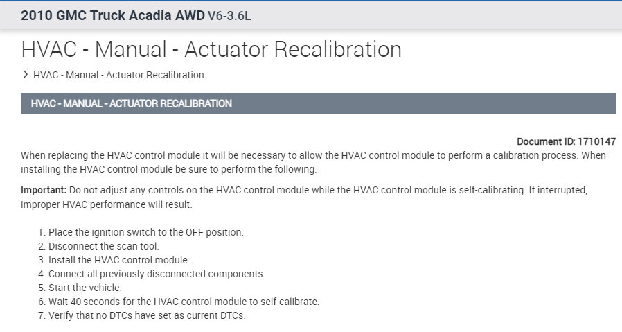

I looked up each code for the manual climate control and both appear to be related to airflow direction. See below.
B3779 08
Air Flow Control 9 Circuit Actuator Stalled
B3782 08
Air Flow Control 10 Circuit Actuator Stalled
The airflow direction is controlled by a mode door actuator. However, that wouldn't cause the issue described. I have a feeling the module itself has failed.

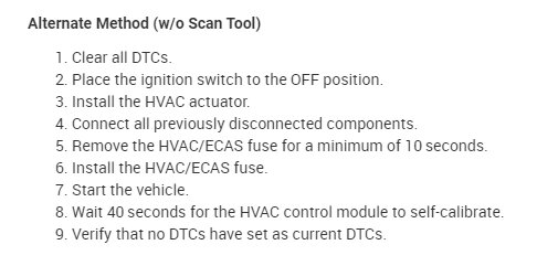

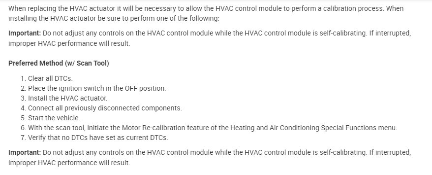

The first thing indicated in the manual is to recalibrate the actuators. I attached directions below. Take a look and let me know if you are comfortable performing it. Note there are two ways to do it. You can use a scan tool or do it manually.
