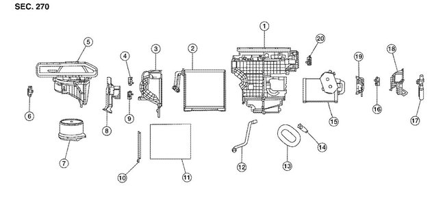

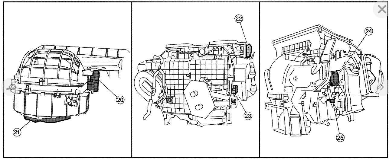

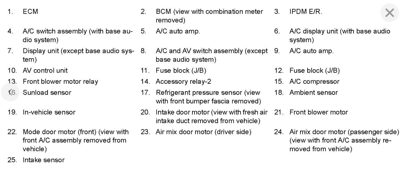

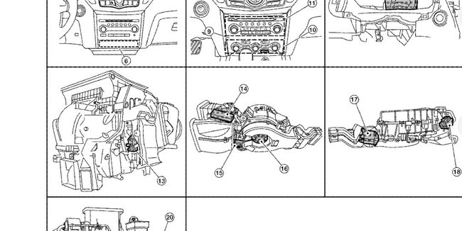

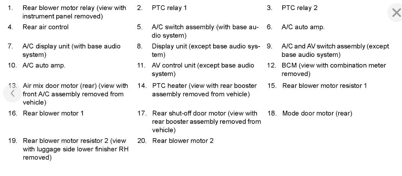

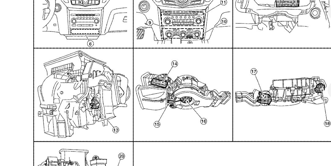

My A/C system is not working correctly. Can someone please tell me where the front driver and passenger blend door motors.
Also if anyone knows how to get to the rear one on the rear unit. Thanks

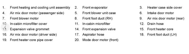

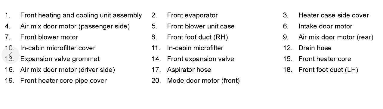

I attached the procedures and pictures for you of the blend door actuators. They are all in the same area.
Let us know if you have any other questions.
Drivers side
DOOR MOTOR
AIR MIX DOOR MOTOR : Removal and Installation - Air Mix Door Motor (Driver Side)
REMOVAL
1.Remove the center console side finisher (LH). Refer to "Exploded View" See: Console > Removal and Replacement > Exploded View.
2.Remove the front foot duct (LH). Refer to "HEATING AND COOLING UNIT ASSEMBLY : Exploded View Front Heating and Cooling Unit Assembly" See: Housing Assembly HVAC > Removal and Replacement > Exploded View.
3.Remove the air mix door motor (driver side) screws.
4.Disconnect the harness connector from the air mix door motor (driver side) and remove.
INSTALLATION
Installation is in the reverse order of removal.
Passenger side
DOOR MOTOR
AIR MIX DOOR MOTOR : Removal and Installation - Air Mix Door Motor (Passenger Side)
REMOVAL
1.Remove the front foot duct (RH). Refer to "HEATING AND COOLING UNIT ASSEMBLY : Exploded View Front Heating and Cooling Unit Assembly" See: Housing Assembly HVAC > Removal and Replacement > Exploded View.
2.Remove the air mix door motor (passenger side) screws.
3.Disconnect the harness connector from the air mix door motor (passenger side) and remove.
INSTALLATION
Rear
DOOR MOTOR
AIR MIX DOOR MOTOR : Removal and Installation - Air Mix Door Motor (Rear)
REMOVAL
1.Remove the glove box assembly. Refer to "Removal and Installation" See: Glove Compartment > Removal and Replacement > Removal and Installation.
2.Remove the front foot duct (RH). Refer to "HEATING AND COOLING UNIT ASSEMBLY : Exploded View Front Heating and Cooling Unit Assembly" See: Housing Assembly HVAC > Removal and Replacement > Exploded View.
3.Remove the air mix door motor (rear) screws.
4.Disconnect the harness connector from the air mix door motor (rear) and remove.
INSTALLATION
May 30, 2020 at 4:49 AM
ASSASSIN1710
This is a little vague. Do you happen to have any better pictures? And more precise instructions.
Jun 1, 2020 at 2:20 AM
That is all there is for the information. The actuators are on the HVAC unit in the locations marked with the diagrams.
I will look for any other pictures for you.
