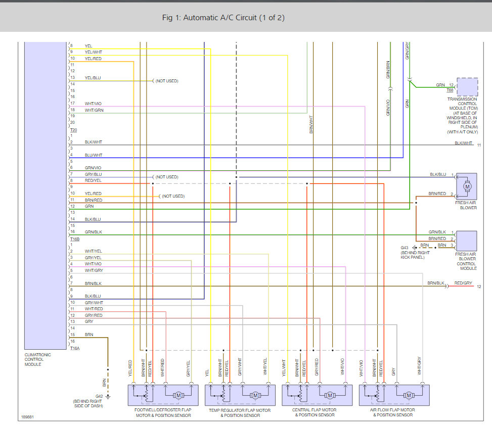

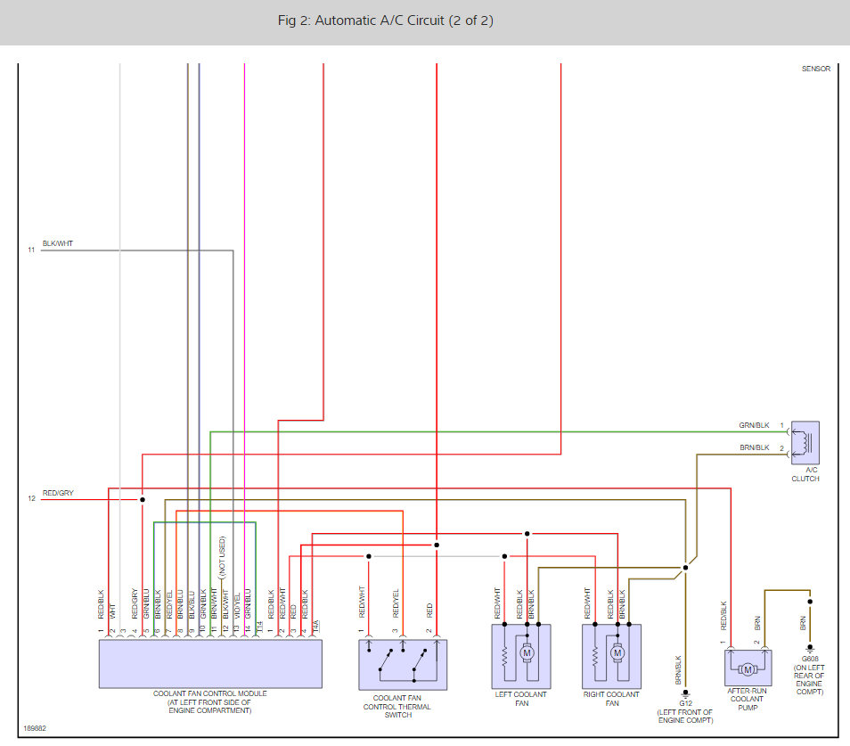

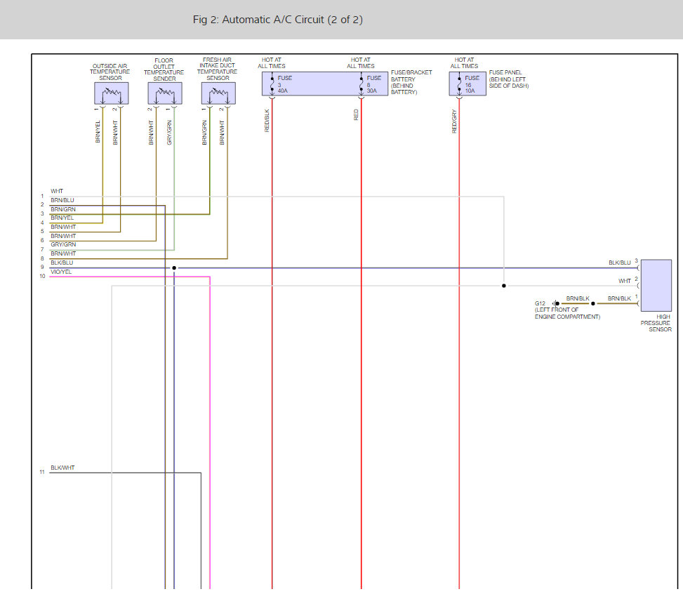

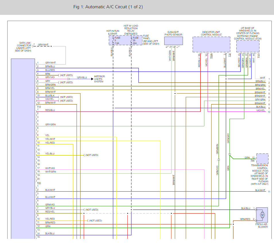

The A/C stopped working out of no where. It was working fine the day before and the next morning it just stopped working. When I press the A/C button the button does not light up like it use to. I checked the fuses and they are in good condition. The A/C blows no air at all and neither does the heater.
Jul 24, 2017 at 12:38 PM
  • 55,746 POSTS
It sounds like the blower motor or the power resistor has gone out but to be sure lets do some testing. Here is a guide and some wiring diagrams so you can test for power and confirm the failure.
and
https://www.2carpros.com/articles/blower-fan-motor-works-on-high-speed-only
Please run some tests and get back to us we are interested to see what it is.
