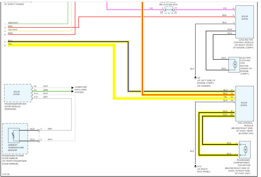

My A/C would sporadically turn on when I would start the car like one time the air would come on full blast super cold. then I do turn the car off and come back and turn bar in and then no air would come through at all.

If it isn't working now, we need to check if the blower motor is getting power.
I attached the wiring schematic below and highlighted the relevant wiring. At the blower motor, there will be two wires. The schematic doesn't provide a color, but the motor itself will only have two wires.
With the fan turned on, check both of the wires. One should have power. Let me know what you find.

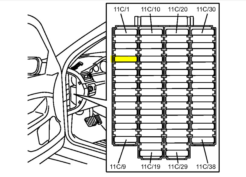

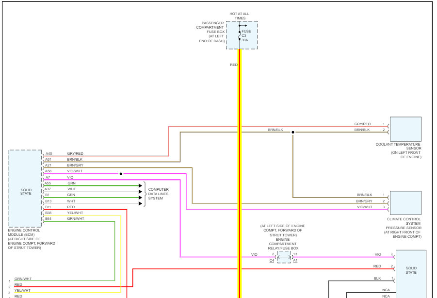

Also, make sure fuse C3 in the fuse box under the left side of the dash is good and has power to it. See pic 3 below.
