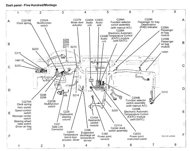

I am fairly mechanically inclined and have checked most of the obvious problems. I am surprised to hear there is no common denominator between these two issues. My guess would have a head gasket or some odd vacuum problem. But I will keep looking. Oh, one thing I did not mention is 90% of the time you turn the climate control system on or off there is a kind of banging noise, like a wooden spoon against a plastic bowl kind of. I thought it was a vent attempting to open or close, but again I found no issues with airflow.

The only thing I can think of it the vibration of the engine must make the mode blend door actuator work. Let check the temperature blend door actuator. Here is a guide that will give you steps the change and check the door operation and the location of the actuator for your car below:
This will make the knock noise as well, put your hand on it to see if it is making the noise before you remove it. Check out the diagrams (below). Please let us know what you find.
