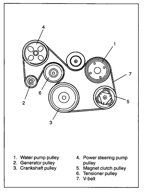

I need a routing diagram for the vehicular listed above with power steering and A/C. Single belt.
Sep 7, 2020 at 7:05 AM (Merged)
STEVE W.
  • 15,421 POSTS
Welcome to 2CarPros. This should be the one you need. Please check the diagrams below to see the serpentine belt routing
