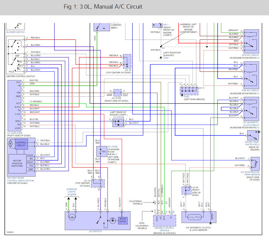

Can I get the wiring or at least pin-out diagram for the AC amplifier assay?
1998 TOYOTA CARINA
85,000 MILES • 1.8L • 4 CYL • 2WD • AUTOMATIC
MIKI#
MEMBER
10 POSTS

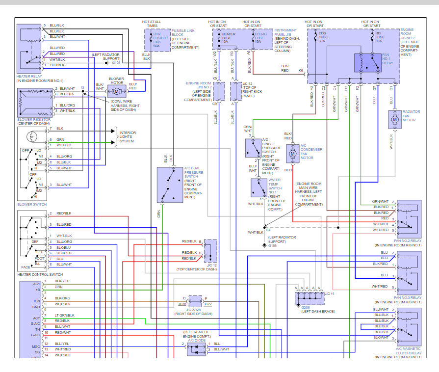

I need wiring or at least pin-out diagram for the AC amplifier assay. The part number is 88650-21070.
Nov 6, 2022 at 7:10 PM
Experienced Mechanic
55,694 POSTS
Sure, here are the AC wiring diagrams you have requested, and I have included a guide to help you run continuity tests.
Check out the images (below). Please let us know if you need anything else to get the problem fixed.
