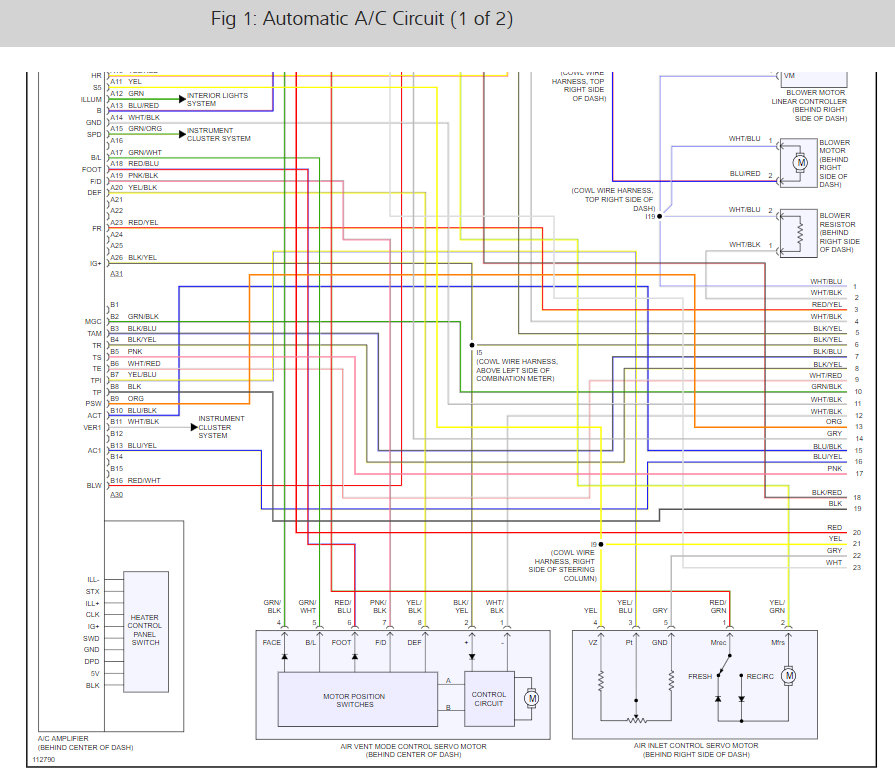

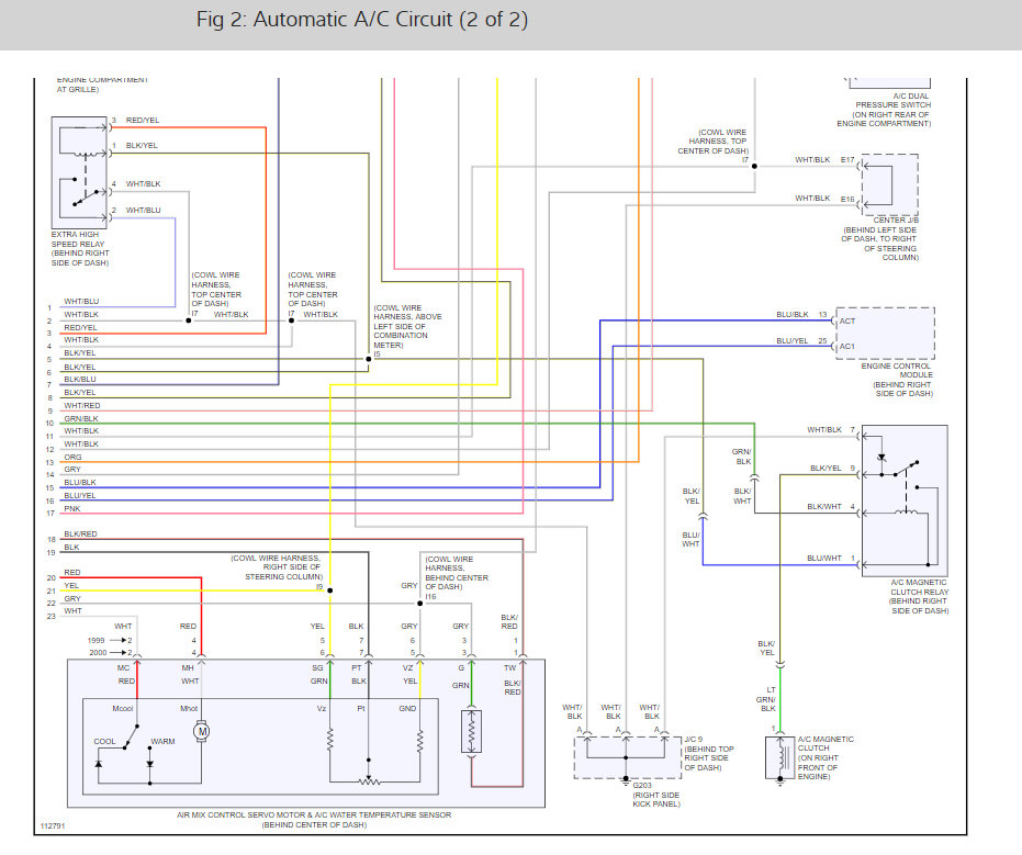

Hi, the A/C in my car is not working.when I push the A/C button the light comes on but compressor is not powered. Kindly help me with the circuit diagram for the said A/C amplifier above.

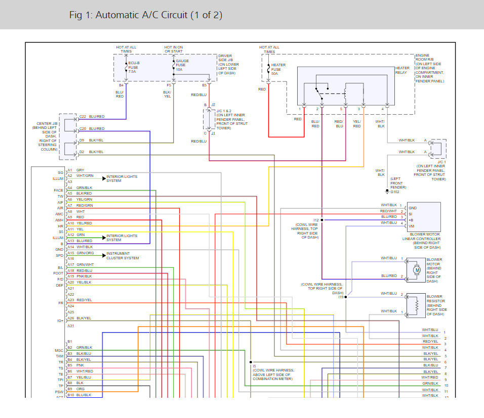

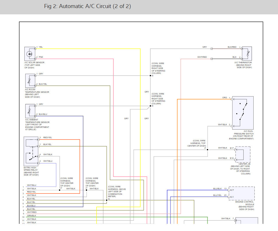

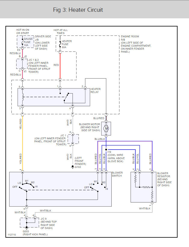

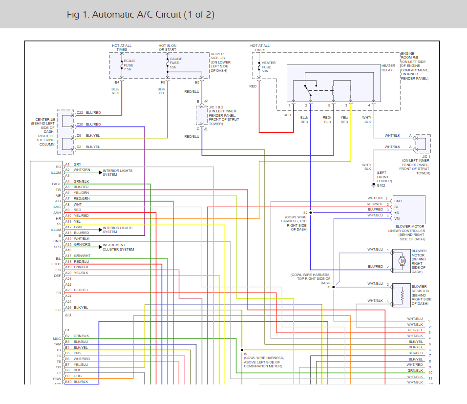

Here is a guide to help you with the testing and the air conditioner wiring diagrams below:
Check out the diagrams (below). Please let us know what you find.
