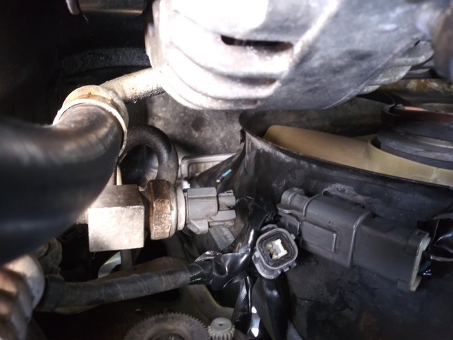

My A/C air stopped blowing cold. The passenger side fan comes on, but the drivers side fan does not before and after the ac is turned on. It is my understanding that both fans should come on at some point. When is that?

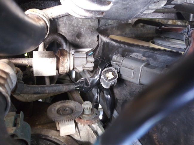

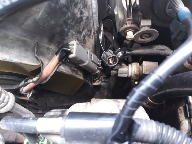

Upon further inspection, I noticed a disconnected wiring harness hanging down, but the middle of the disconnected wire that was stuck in the plastic clip of the larger wiring harness. The two wiring harnesses in question are located to the passenger side of the radiator fan cover. The main wire separates into one disconnected small round gray wiring harness and one larger square gray connected wiring harness. I wires did not have any tape or plastic coil protection; so, taped the the (white, red, gray) wiring with black electrical tape. I could see where the small round gray harness plugs in at. Where does the gray smaller wiring harness in the attached photo plug in at and what is the name of the wire and what it goes to?
What is the most likely possibility for the air to only blow room temperature air and stop blowing cold air?

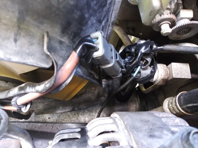

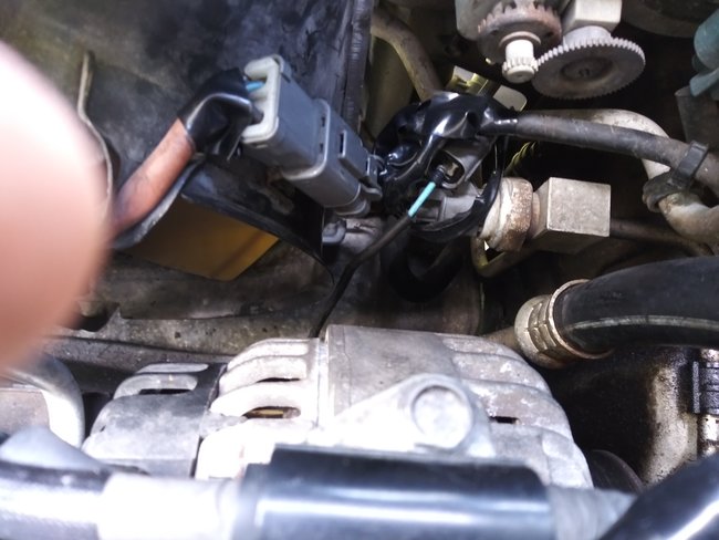

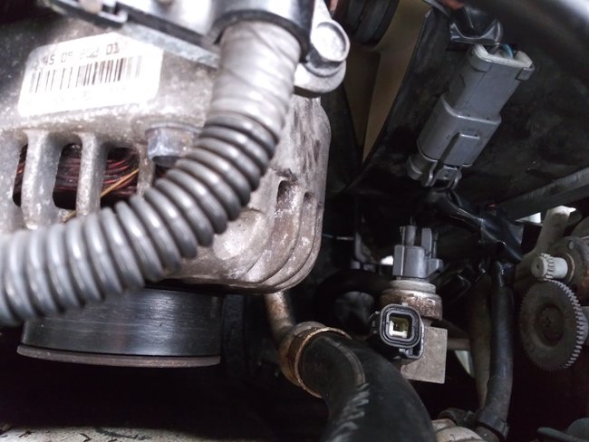

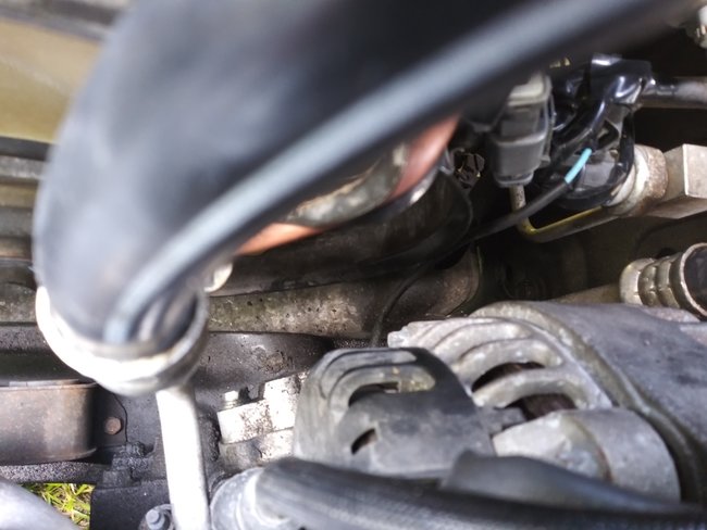

While waiting for your reply, I decided to do some more research. I was looking see if I could find where the small (red single wire) disconnected harness might go to. I found a disconnected blue wire with a small pin socket underneath the radiator fan cover. I imagined the connection to the small wire harness to look the same as what it plugs into, but the blue wire fits perfectly in the one pin inside the small harness. The blue wire runs to a the part that looks like a motor underneath the alternator. It might be the the connection I was looking for. I don't see anything else that it might plug into. I've attached a photo. Please research, troubleshoot, diagnose and help solve this trouble.
What is the motor underneath the alternator called and is the blue wire the correct connection to the small gray disconnected wiring harness in question?

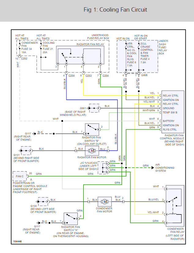

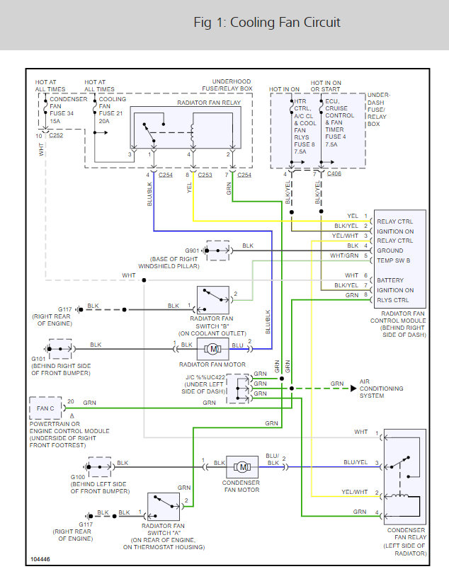

It looks like you have some wiring issues for sure. lets fix the issue by following this guide to check the wiring with the engine cooling fan wiring diagrams below.
Check out the diagrams (below). Please run some tests and get back to us. make sure to check the relay as well.

My A.C. started working again after I made the connection with the 2 disconnected wires. The 2 previously described wires above, the red and blue one going to the radiator cooling fan motor. I don't know how they were unplugged. You probably have some experience or knowledge about this with other vehicles.
This appears to have solved the A C problem. For now, this case appears to be solved.
