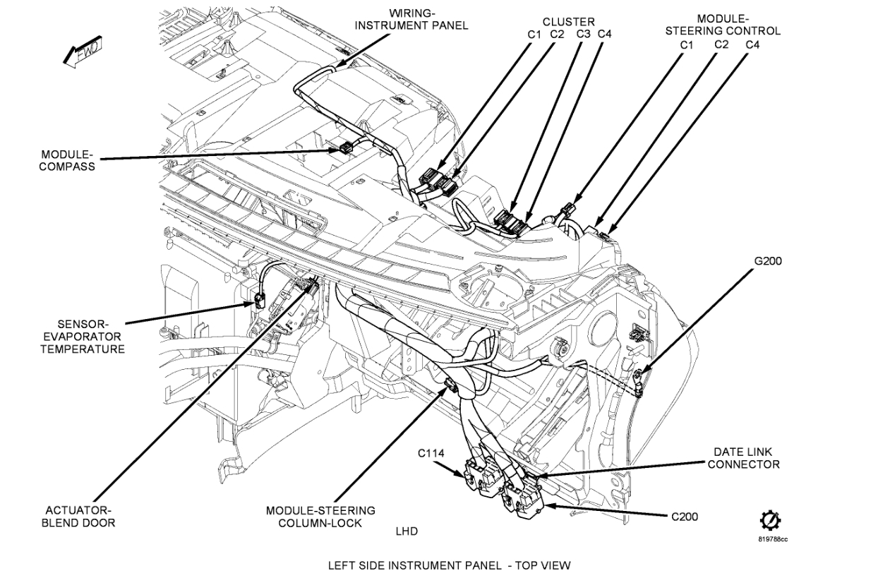

Next the left or drivers side blend door actuator is not working which is common. Here is the location and how to change it out in the diagrams below. Check out the diagrams (below). Please let us know what happens.
Jul 31, 2022 at 6:16 AM
PETER1974
  • 13 POSTS

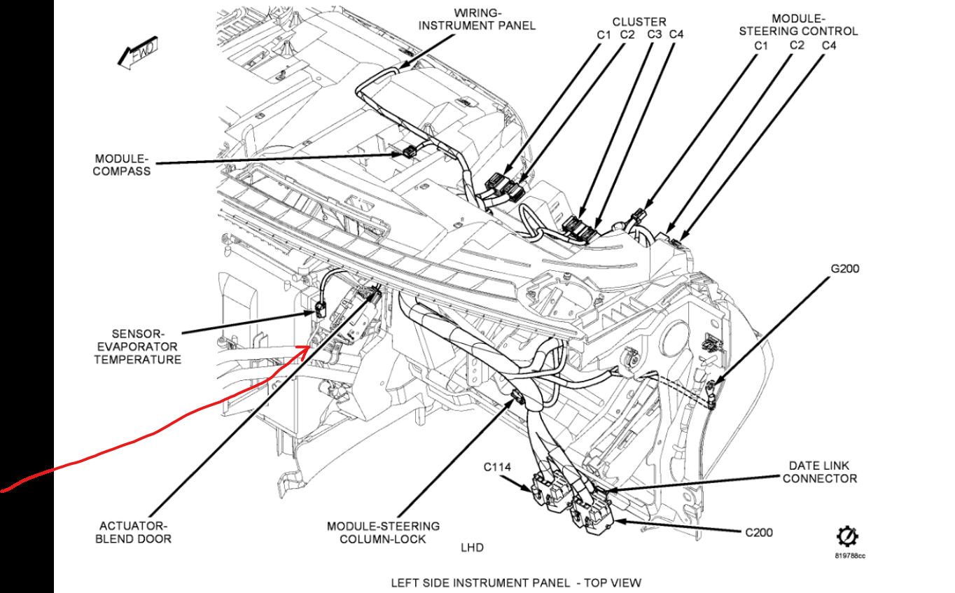

This chart doesn't look like my model, I can't read it and can't locate it. I observed that my car has three blend door actuators, I don't know which one is faulty.
Aug 11, 2022 at 6:34 PM
  • 55,616 POSTS

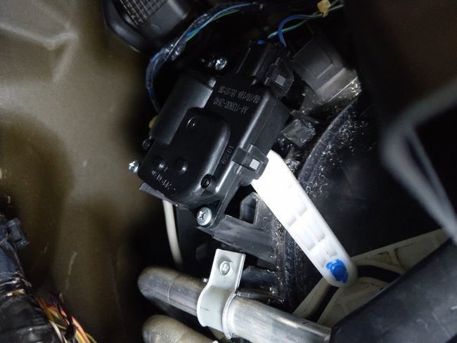

I put a red arrow on the location of the blend door actuator you need to change out. It is on the driver's side above the throttle pedal.
Aug 12, 2022 at 4:12 AM
PETER1974
  • 13 POSTS
I got a new one today and it works fine. thank you very much.
