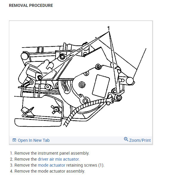

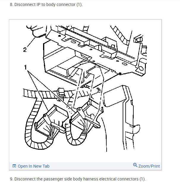

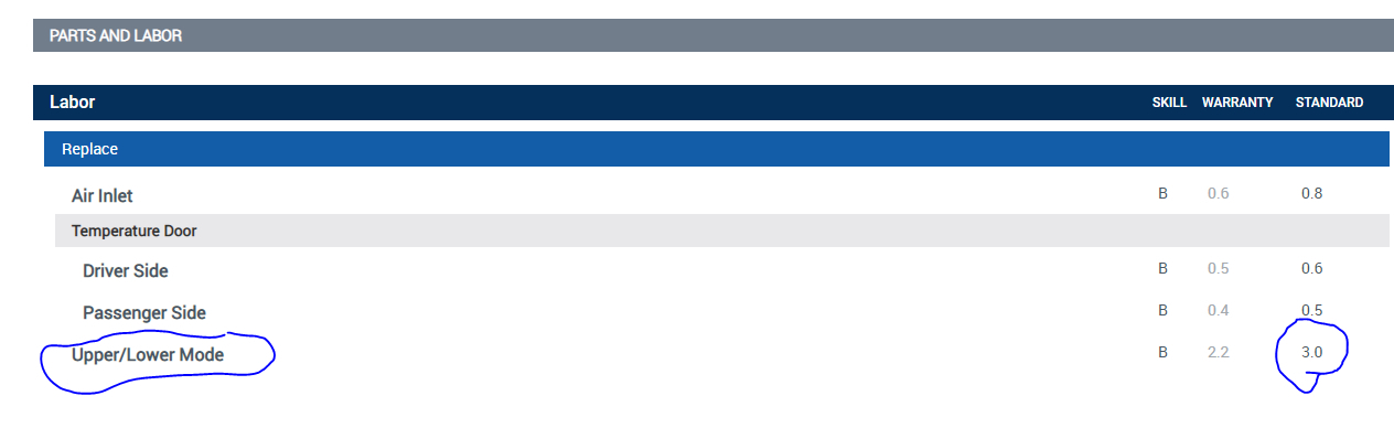

my air just goes to window not my center vent. I will start the car and it will come through the center vent but then go back to the defrost and I do here a noise seems like it coming from being the dash and I can change it from hot to cold. help please.
Jul 23, 2021 at 2:46 AM
Good morning,

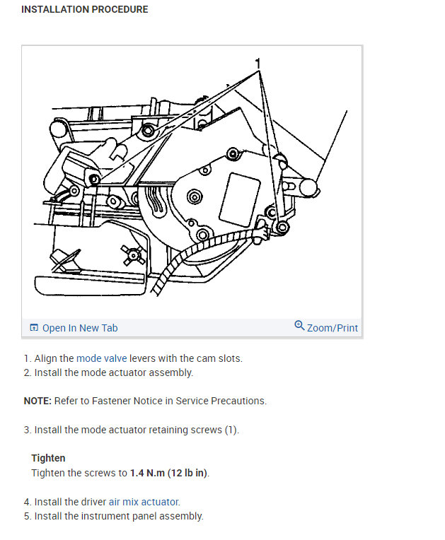

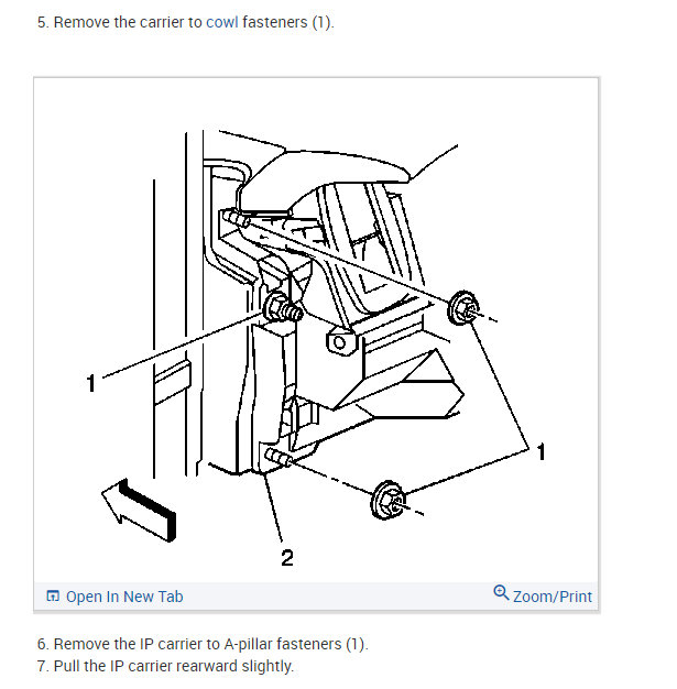

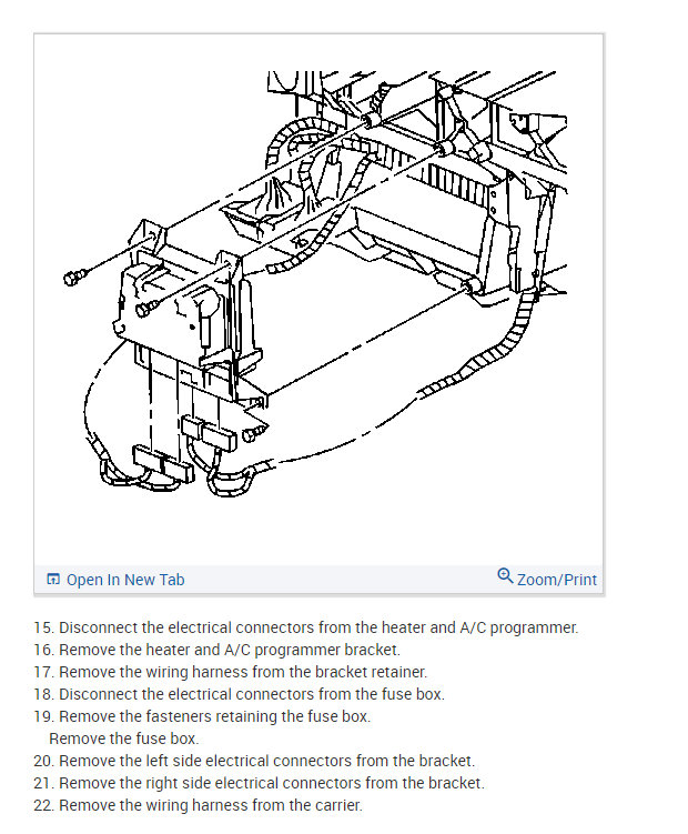

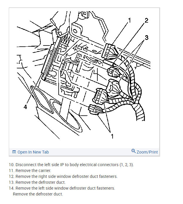

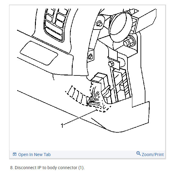

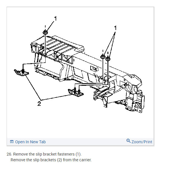

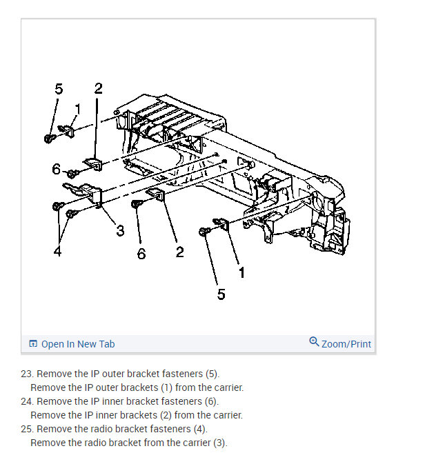

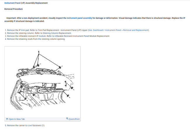

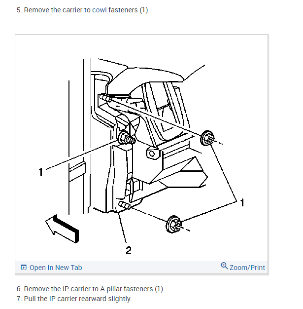

The mode door actuator is most likely the issue. The noise is the key as when the gears go bad, they make noise.

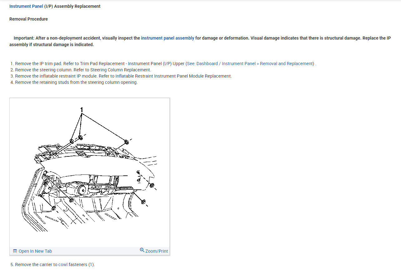

https://www.2carpros.com/articles/air-vents-stay-in-the-defrost-position
I attached a procedure for you. The dashboard has to be removed to gain access to the actuator.
