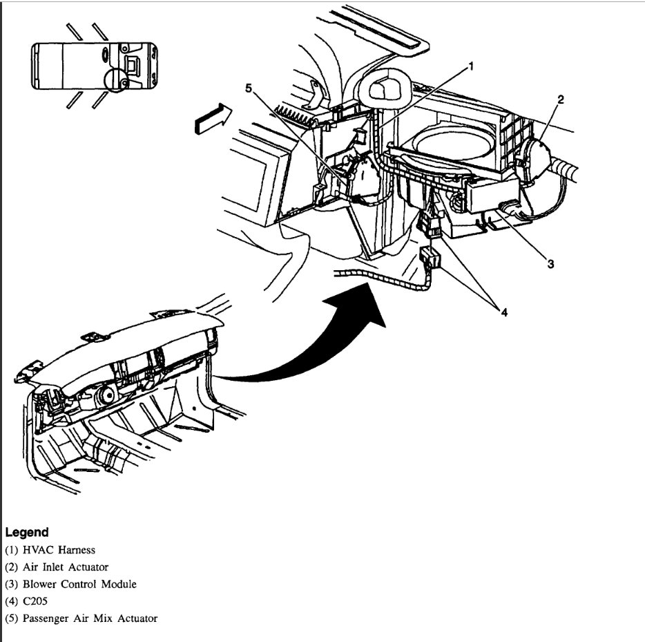

It should be the air inlet actuator that is causing the issue but to be sure remove the actuator and work the pivot for the air door by hand with the system running to see how it affects the air flow.
Here is a diagram (below) to show you the location and check the guide above for reference. Please run this test and get back to us.

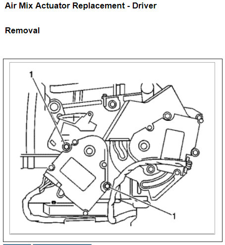

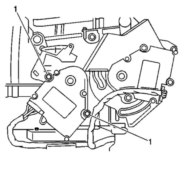

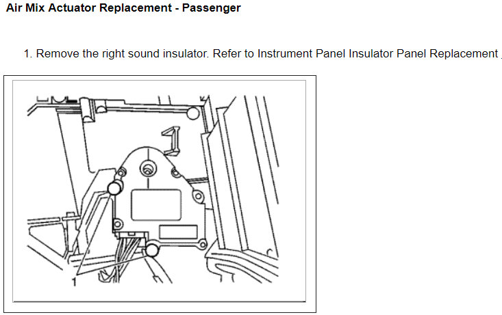

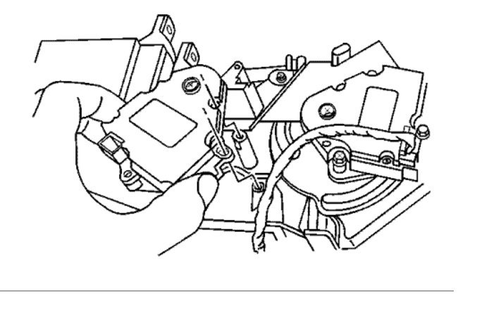

Not sure if they are all the same. There are four actuators when you remove one turn the system on and move the pivot by hand this will let you know which one does what.
Here are the other two actuators. Looks like there are only three.
