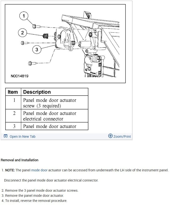

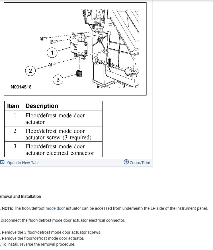

Where is the mode door actuator located?
2005 FORD F-150
200,000 MILES
ZANMAN
AC actuator's location.
Jul 15, 2025 at 2:15 PM
STEVE W.
  • 15,349 POSTS
Which one? There is one that selects floor or defrost, that one is on the left side of the HVAC case just above the footwell, the actuator that selects the front panel vents is just above it the attached are the locations and r&r process.
