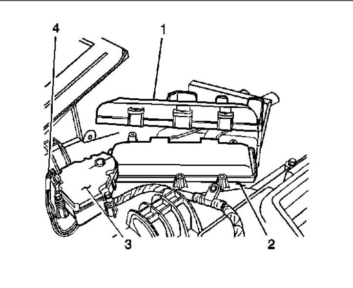

Driver side blows cold and passenger side blows hot
2005 CHEVROLET TAHOE
206,000 MILES • 5.3L • V8 • 2WD • AUTOMATIC
BRANDON RHODES
ac actuators? It has dual climate controls.
Feb 26, 2021 at 4:40 AM
Good morning,
I attached the procedure below for you for the repair. It requires the removal of the dashboard to access the actuator itself. The book pays almost 6 hours in a shop. I would at least double it if you are doing the repair.
AIR TEMPERATURE ACTUATOR REPLACEMENT - RIGHT
REMOVAL PROCEDURE
1. Remove the I/P carrier.
2. Disconnect the electrical connector (4) from the right air temperature actuator (3).
3. Remove the screws from the right air temperature actuator (3).
4. Remove the right air temperature actuator (3) from the HVAC module assembly (2).
