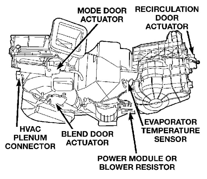

Clicking noise, this car has three actuators, where are they located at, I was told the third was underneath by the gas pedal, one on driver side and the other two behind glove box. I need to find the one on the driver's side. thank you

Please see image below for the location of all 3 actuators.
There are 2 actuators at the driver's side.
