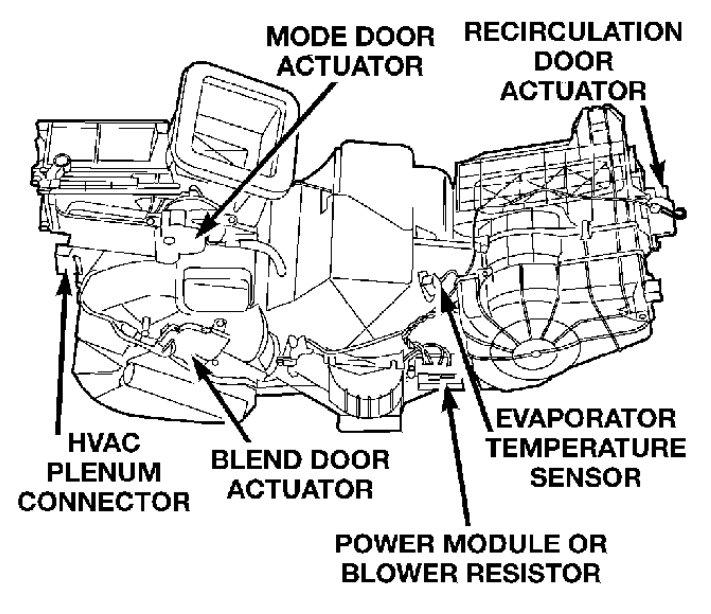

Where is the driver's side A/C actuator located?
2013 CHRYSLER 200
96,200 MILES • 2.4L • 4 CYL • 2WD • AUTOMATIC
BADBOYROD
  • 16 POSTS
Clicking noise, this car has three actuators, where are they located at, I was told the third was underneath by the gas pedal, one on driver side and the other two behind glove box. I need to find the one on the driver's side. thank you
Apr 10, 2022 at 9:58 AM
BORIS K
  • 836 POSTS
Please see image below for the location of all 3 actuators.
There are 2 actuators at the driver's side.
A general guide on how to replace an actuator.
A good video.
https://youtu.be/dTVUKoFb2Lc
Please let us know how you get along.
Cheers, Boris
