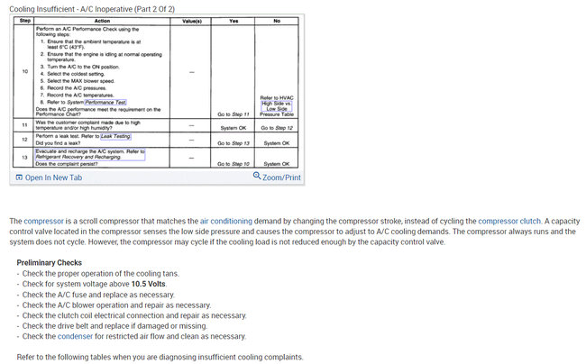

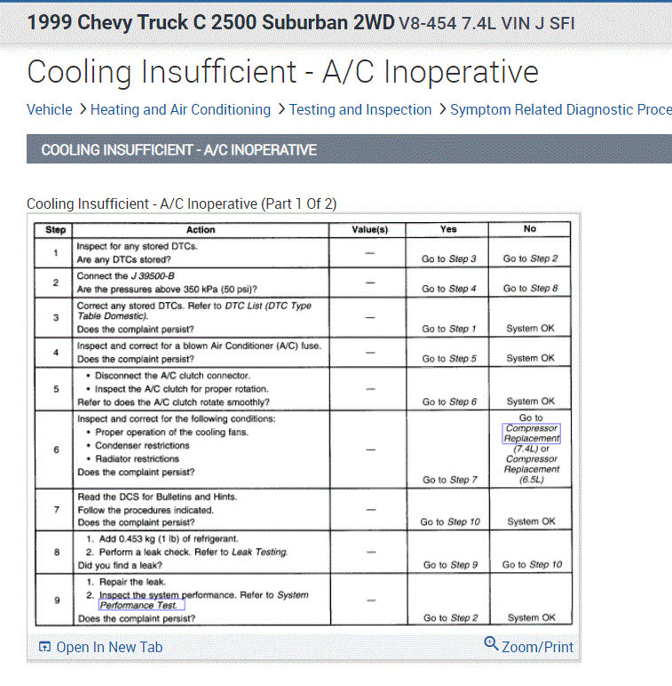

A/C temperature at the vent drops to only 80 degrees when outside is 90.
High and low pressures seem to be normal.
Uses scroll compressor which changes stroke instead of cycling on/off.
Shop manual says any clutch cycling (which I see) happens when “capacity control valve” does not reduce the cooling load.
After 85 miles of driving the temperature at the accumulator top which normally shows frost was 150 degrees.
Upon startup the accumulator temperature drops from 90 degrees to about 85 degrees.
Accumulator and compressor are both 8 years old.
Is it the “capacity control valve” or a clogged “accumulator“?

The high low pressures are within the “white” area of the shop manual graph with temps around 90 degrees.
Scroll compressor is not supposed to cycle off but if it does- shop manual says if clutch does cycle off, then “capacity control valve” would be the cause. Would the CCV explain both abnormal clutch cycle and low?
