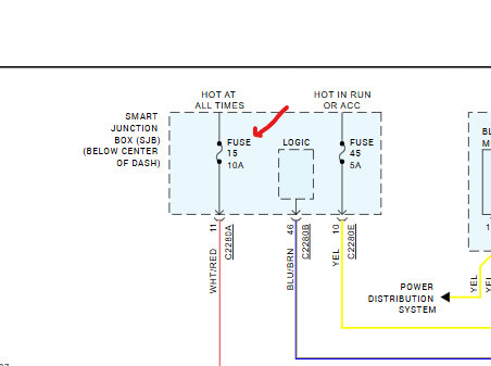

The A/C, Max A/C, and Recirc accessory button lights do not work.

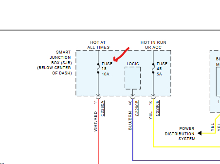

I would start by checking the fuses. Here is a guide and I have included the fuses, and their locations ine the images below.
The fuse is #15 in the fuse panel below the center of the dash. Check out the images (below). Let us know how it goes.
