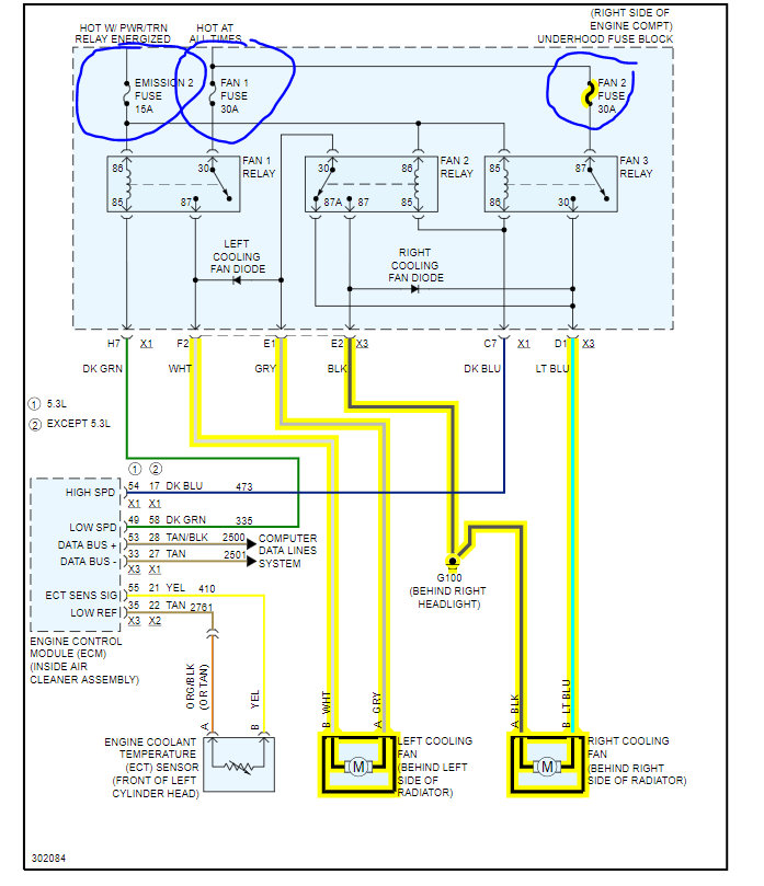

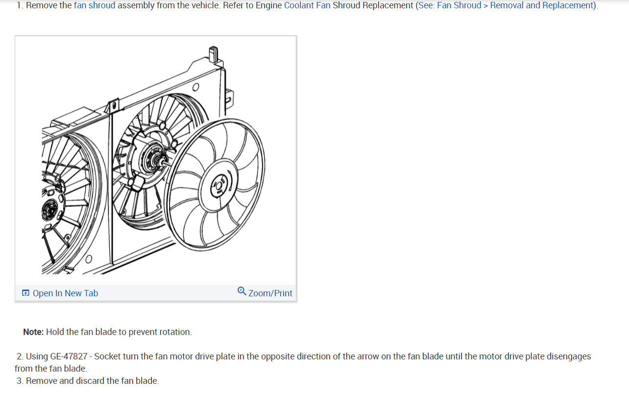

Cutting on the A/C one of the fans is not working. could it be a fuse? i'm also changed me cramshaft sensor and pig tail, but my check engine light is on.
Jun 17, 2021 at 8:15 PM
Good morning,

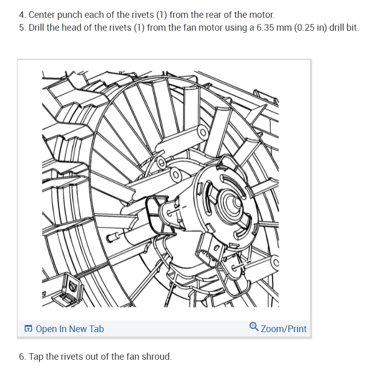

I attached a wiring diagram for you to view. There are 2 fuses for this system. Check for power on both sides of the fuse with the key in the on position.

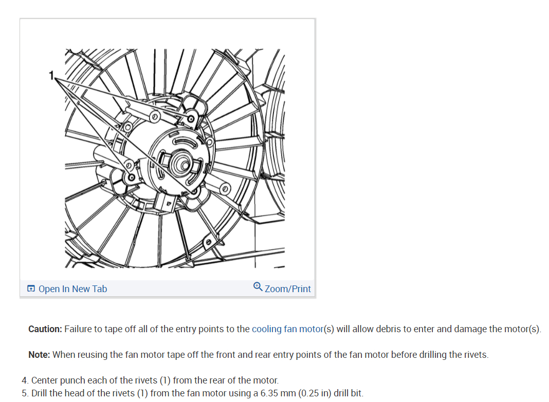

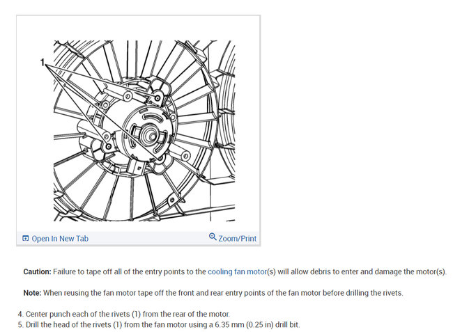

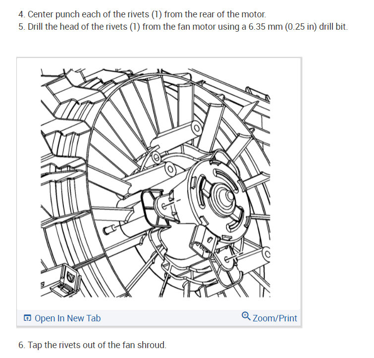

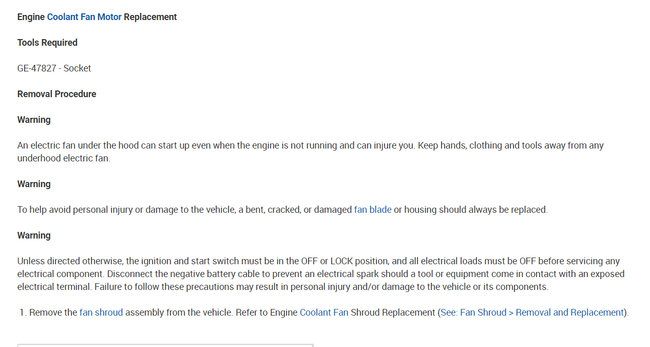

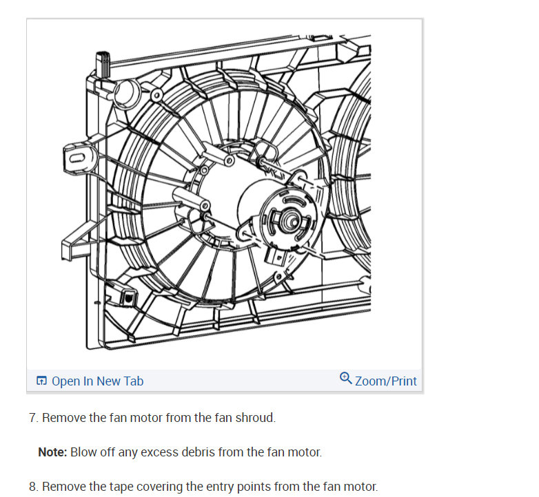

If you do have a bad fuse, you need to fix the reason it failed. Most likely it is the fan motor itself. I attached the procedure for replacing the motor as well.
https://www.2carpros.com/articles/replace-electric-fan-motor
