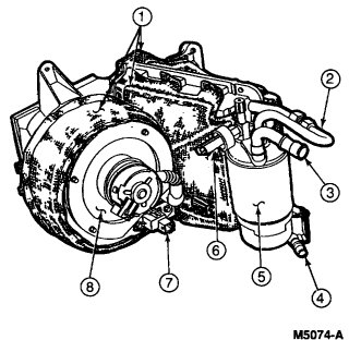

The air conditioner will not turn on on, we put Freon in it, but it is still blowing hot air. What can we do to fix this?

It is blowing hot, the clutch clicks on, then clicks right off, the pressure is good because it is not making noise, so would any of that you told me be a cause of this?

You can do a simple test to check the low pressure sensor on the accumulator. Disconnect the sensor and using a paper clip jump the two pins. If the compressor kicks on and blows cold then the pressure switch needs to be replace. Very common problem on these Fords. Attached photo. #6 is the pressure switch. Hope this helps.
