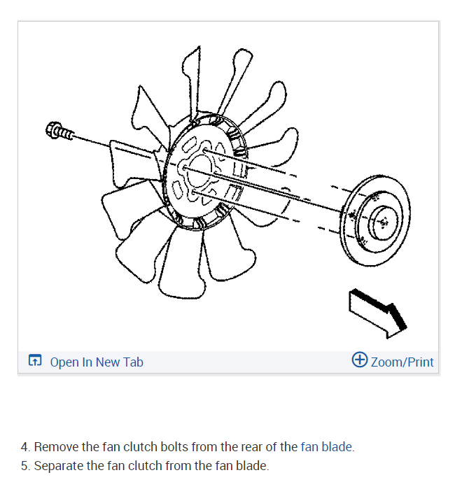

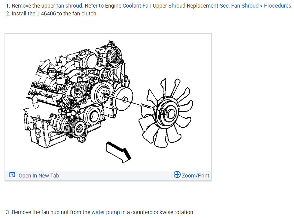

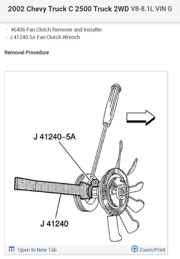

There is only one reason the high-pressure relief valve pops off, excessive high pressure. Can I ask what the high side pressure was before this happened? It should not be over 300 PSI, this is about when the valve lets go. Also make sure your cooling fan is working. Please go over this video:
https://youtu.be/4EqdrBVb0sY?si=-Og3npCLAyKLG-d2
If the fan clutch needs to be replaced, you might see oil/grease around the input shaft. Here is how to change it out, I would use an OEM unit they work best.
This video will how to r&r the fan clutch
https://youtu.be/PoVQpbkCvtc?si=qwF48CLtQZBPzb7r
Check out the images (below). Please upload pictures or videos in your response to any problems so we can see what to help you with.
