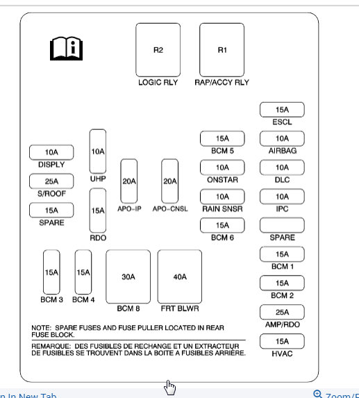

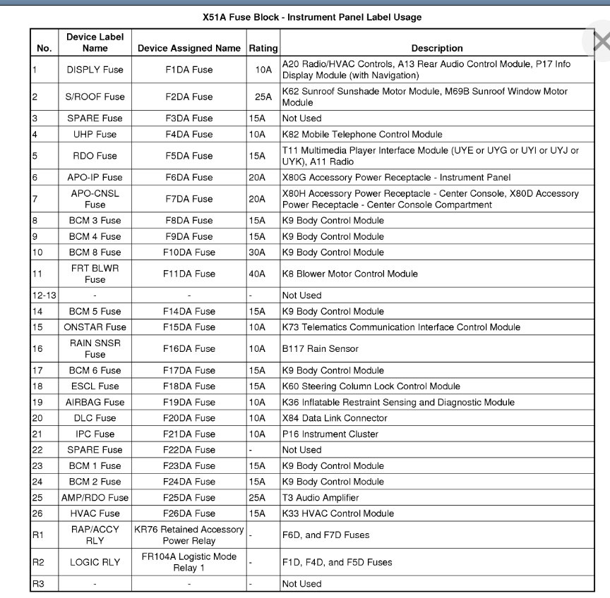

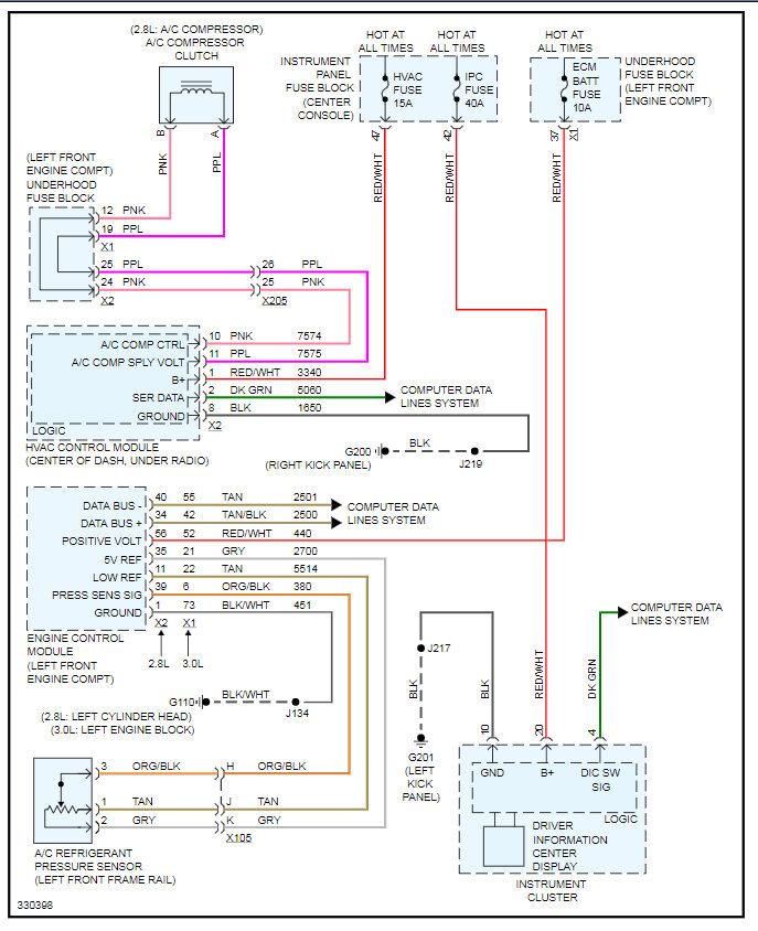

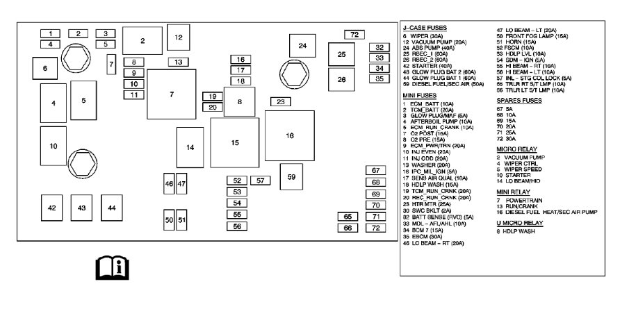

Wanted to know what fuses and where to find the fuses that I need to check in inspection of proper working A/C.
Saturday, July 18th, 2020 AT 8:26 AM
MECHANIC
18,907 POSTS
I attached the wiring diagram for the A/C system. This includes the specific fuses and the location of the fuse blocks so that you can find each.
Also, here is a guide that will help with A/C systems that are not working:
Let us know what you find. Thanks
