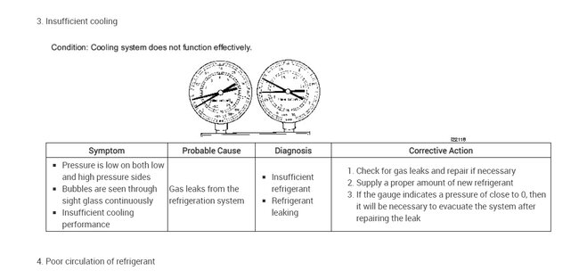

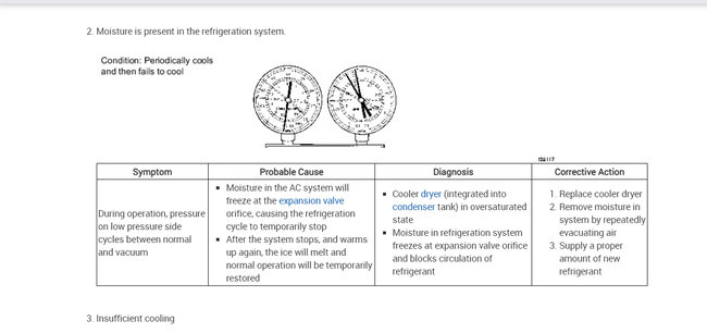

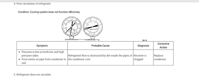

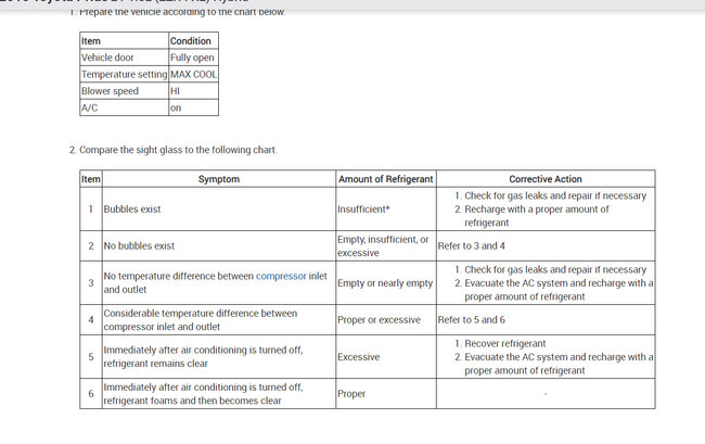

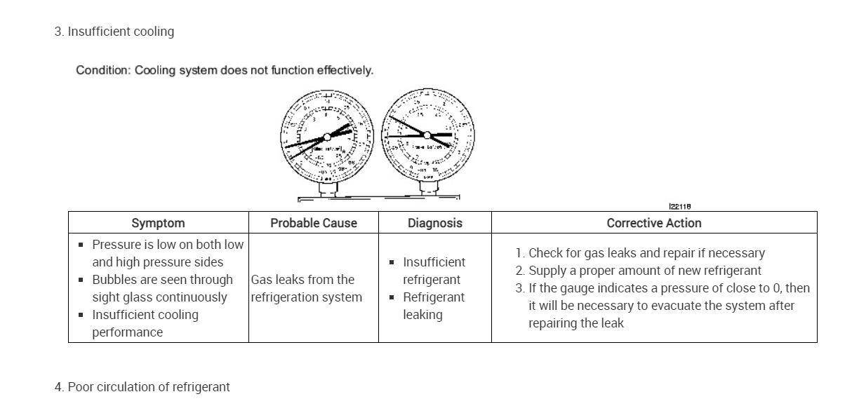

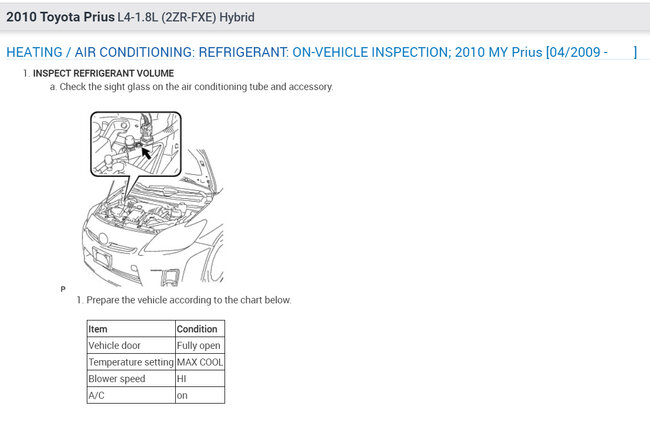

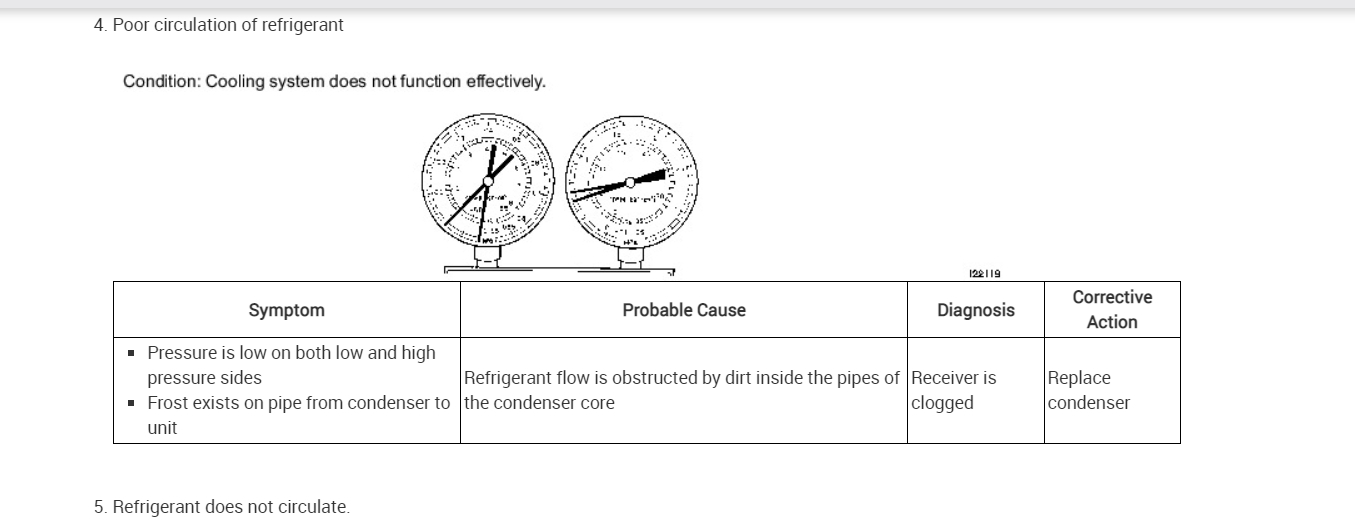

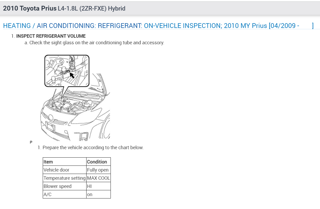

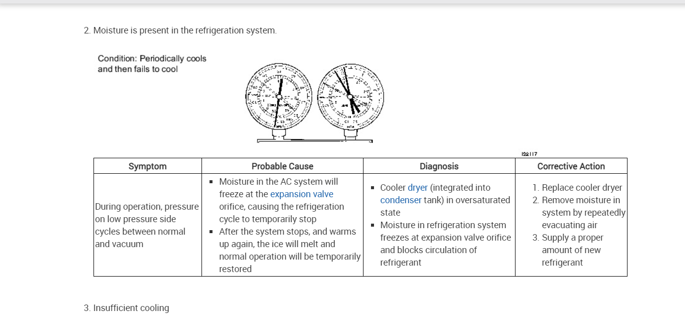

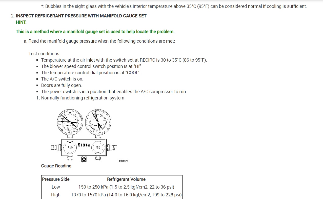

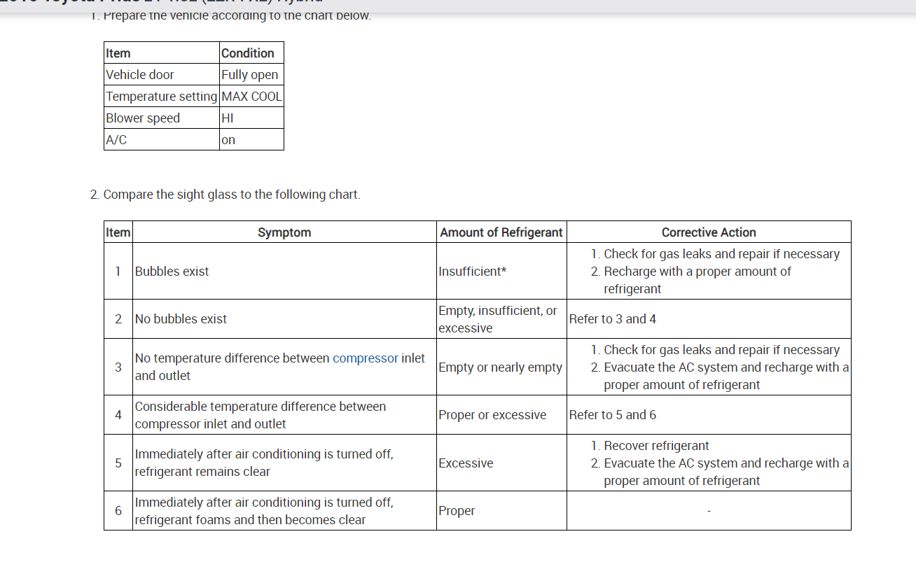

Sure, here is the information you have requested, and I have included a video of how to vacuum down and recharge the system.
https://youtu.be/4EqdrBVb0sY
Compressor oil - ND-OIL 11 or equivalent
Charge with refrigerant HFC-134a (R134a).
Here are instructions on how to charge the system in the images below. Please let us know if you need anything else to get the problem fixed.
