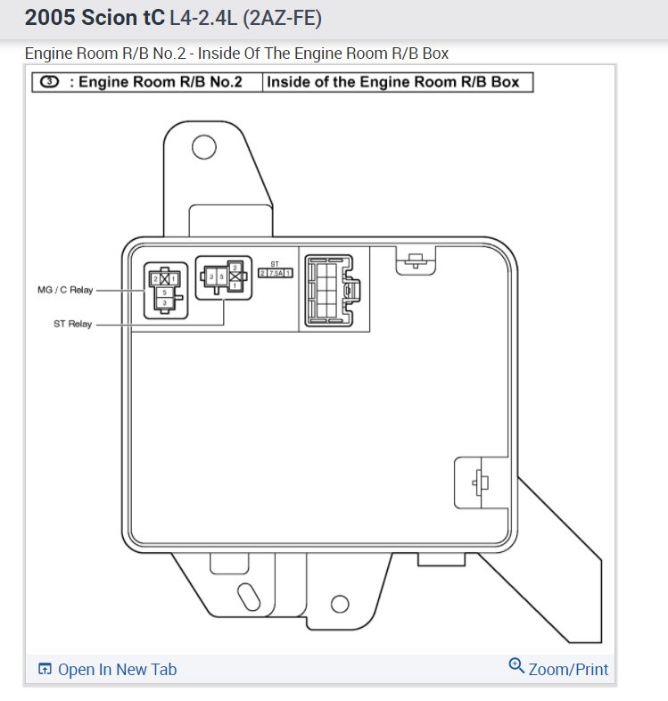

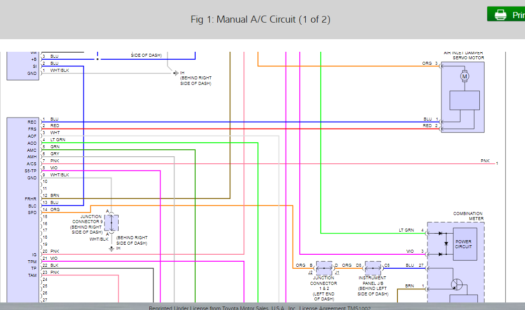

I can't tell which fuse is the A/C clutch relay.
Looked in manual and on fuse box.
I want to try and engage my clutch which isn't spinning with air on.
Apr 27, 2019 at 6:57 AM
SCGRANTURISMO
  • 4,897 POSTS

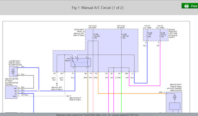

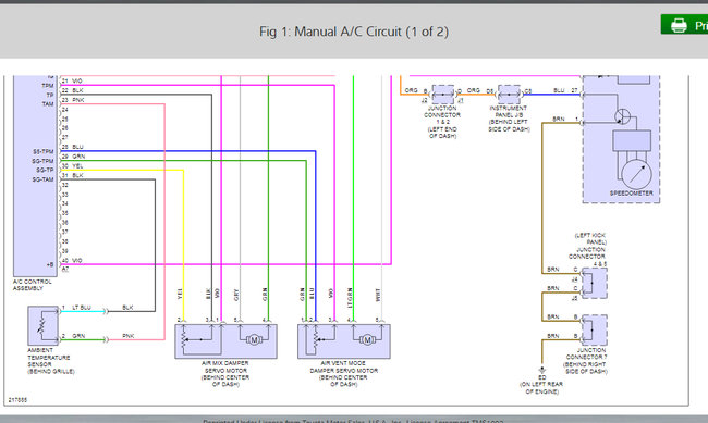

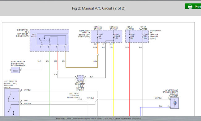

I have sent you your vehicle's Air Conditioning Circuit Wiring Diagrams in the diagrams below and the relay location as well. Please go through them and get back to us with what you are able to find out about the relay. Here is a guide to help test the relay.
Check out the diagrams (Below). Please let us know what you find.
