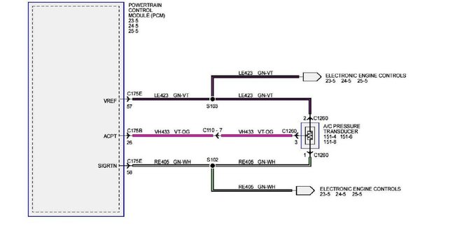

I have replaced the relay, drier, and high and low side valves. It has low pressure on the high side, and high pressure on the low side. Sometimes it will work for a twenty minutes or so, but most of the time it will not cool at all. Could this be a compressor issue?

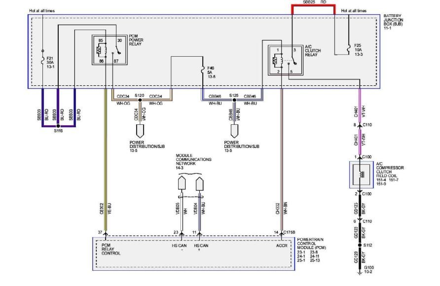

The compressor does not engage, I have jumped the low pressure relay and it will engage then, but otherwise no.

There was a relay in the fuse box under the hood that I could jump with a wire and the compressor would start running. That is the one I replaced.
Jul 2, 2018 at 3:28 AM
That is the clutch relay. Jumping it does not mean it is bad. It means the control side was not grounded by the PCM because it did not see the proper signal.

The low side dropping to 10 lbs is no good. It should be 25-30 lbs and stay rock solid.
You have an issue with that but it will not effect the compressor from kicking on. At 20 lbs the system should kick on by itself.
At the very least, you need an expansion valve and a drier.
You need to test for power to the relay key on engine off. There should be two powers present.
