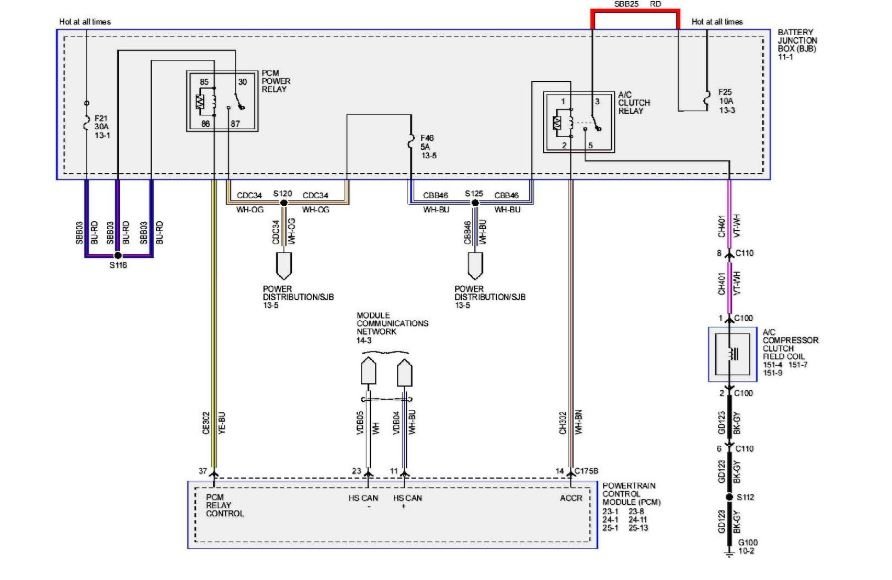

I have replaced the relay, drier, and high and low side valves. It has low pressure on the high side, and high pressure on the low side. Sometimes it will work for a twenty minutes or so, but most of the time it will not cool at all. Could this be a compressor issue?

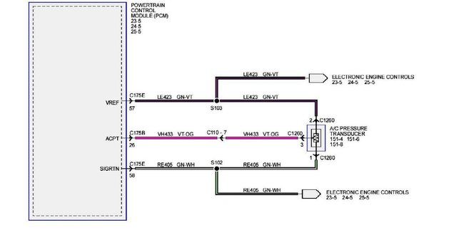

If you jumped the low pressure switch and it comes on, replace the switch. It needs 20 lbs on the low side to engage the relay.

That is the clutch relay. Jumping it does not mean it is bad. It means the control side was not grounded by the PCM because it did not see the proper signal.

Okay, I got some gauges. At a idle with the AC turned on high, the compressor will not engage and the pressure is 90 lbs on both the high and low side. When I jump the relay and start the compressor the low side drops to 40 lbs and the high side will climb to 325 lbs at that point the fan on the radiator will turn on when that happens the low side drops to 10 lbs and the high side drops to 125 lbs, the the fan turns off and the pressure starts to climb again.
Jul 4, 2018 at 5:18 AM
The low side dropping to 10 lbs is no good. It should be 25-30 lbs and stay rock solid.
You have an issue with that but it will not effect the compressor from kicking on. At 20 lbs the system should kick on by itself.
At the very least, you need an expansion valve and a drier.
You need to test for power to the relay key on engine off. There should be two powers present.
