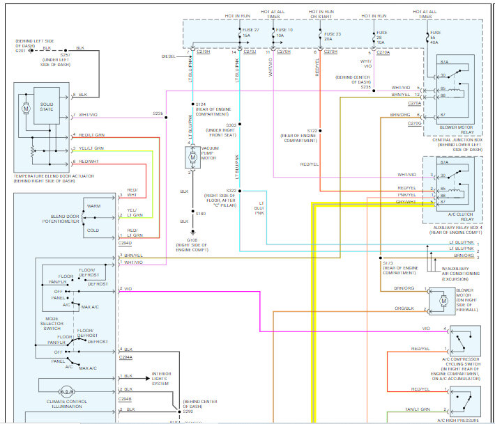

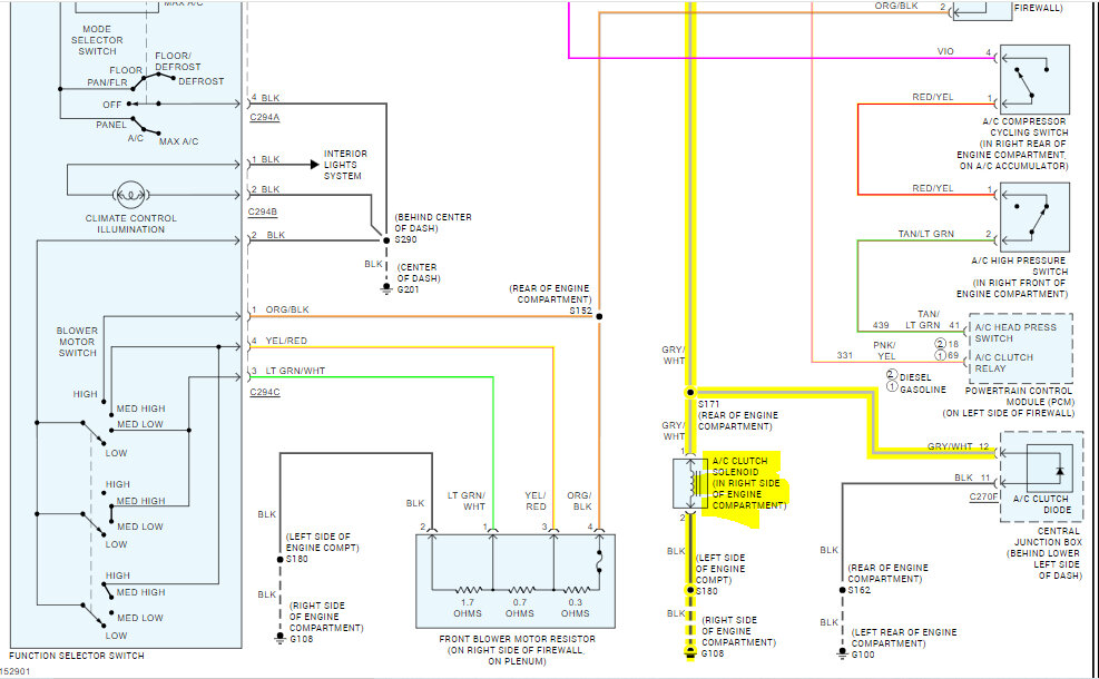

Installing a new A/C compressor. Someone cut a few wires. i don't know what goes to what. anyway, i could get a wiring diagram for the A/C compressor.
Apr 1, 2024 at 11:32 AM
  • 110,194 POSTS
I attached the schematic below for the circuit. Note that at the compressor clutch, there should only be two wires. One is gray with a white tracer and the other is black.
Take a look and let me know if this helps.
see pics below. Note: I cut the page in half to make it readable.
