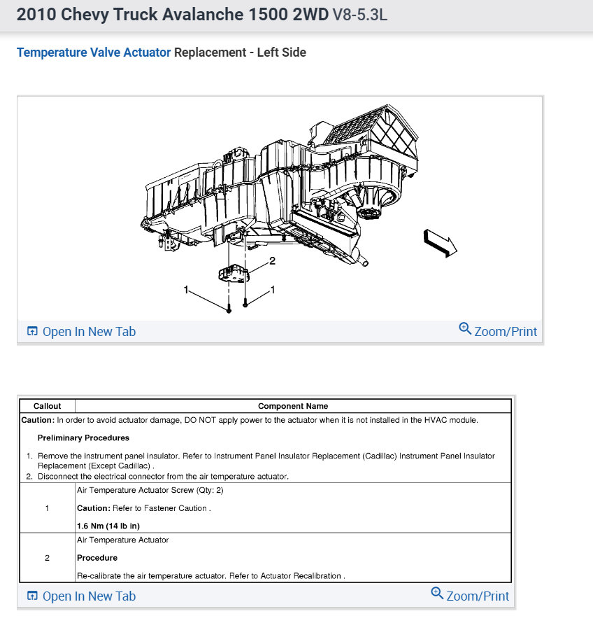

Ac Blend door actuator driver side where is it Is located?
2010 CHEVROLET AVALANCHE
136,000 MILES • 5.3L • V8 • 4WD • AUTOMATIC
JAVI5631
Aug 3, 2022 at 3:47 AM
  • 55,216 POSTS

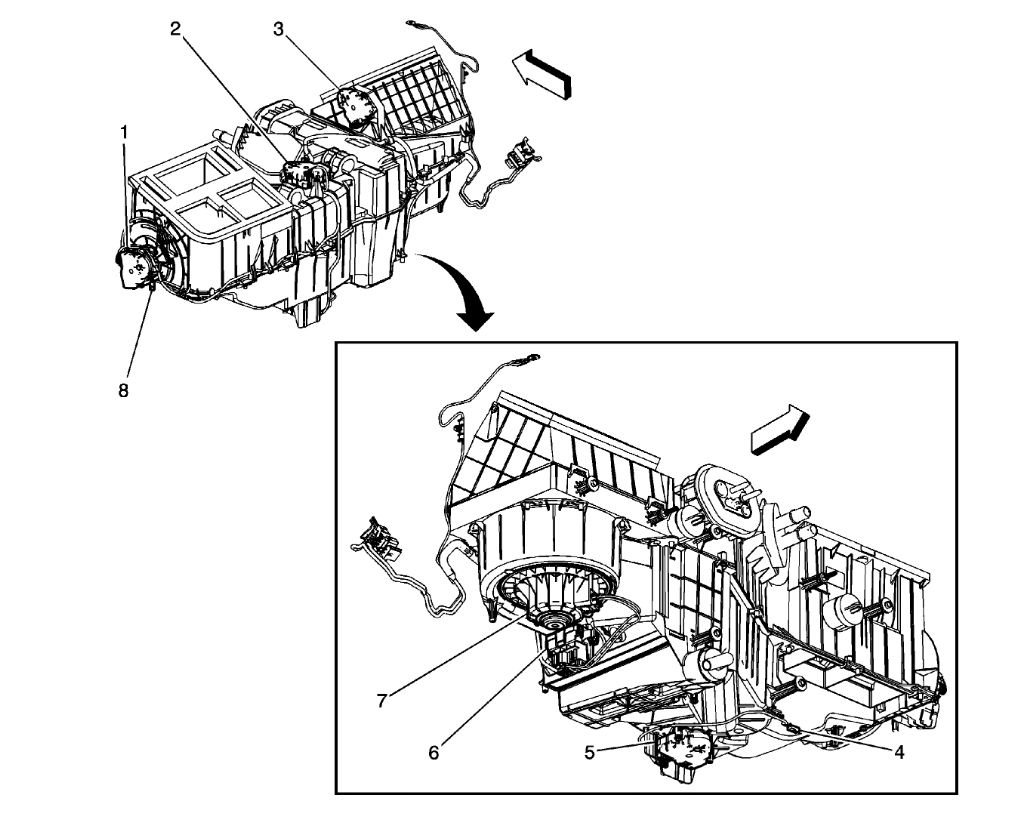

The driver side blend door actuator is on the left side of the vehicle under the dash above the throttle pedal. Here is the location and how to change it out in the diagrams below. I have also included a generic guide to show you what you are getting into when doing the job.
1 - Mode Actuator
2 - Air Temperature Actuator - Right
3 - Recirculation Actuator
4 - Air Temperature Sensor - Lower Right (CJ2)
5 - Air Temperature Actuator - Left
6 - Blower Motor Control Module
7 - Blower Motor
8 - Air Temperature Sensor - Lower Left (CJ2)
