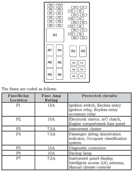

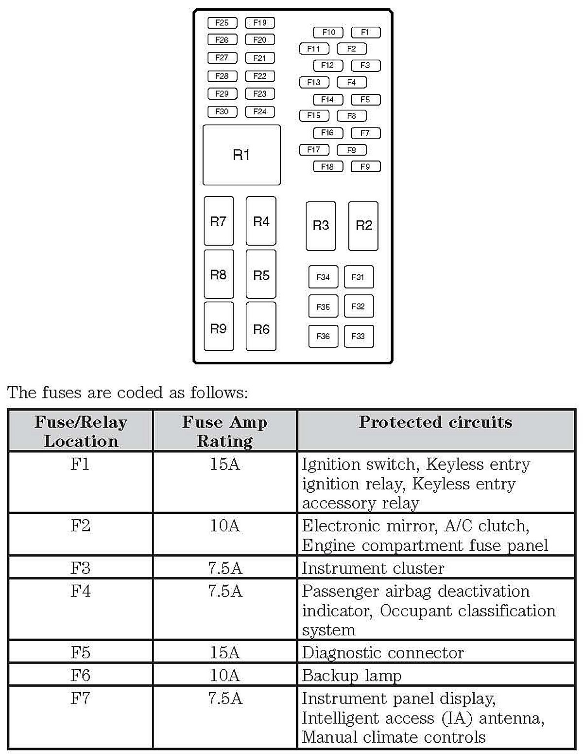

Worked fine all day then stopped and was out of the car for an hour or so. On the fifteen minute drive home the AC was blowing cold and then poof now it blows warm. Got the car home let it cool down and restarted it and turned the AC on max and fan on high it blew cold for two to three seconds and it is warm again. Today I went out and purchased a can to recharge the AC and place the valve on the low side and the gauge was in the red around 150 with the car running and the AC on max with the fan on high. Then I turned to YouTube and found your video. I do believe I checked all the fuses outside and inside under the glove box. I am not saying I missed one but nothing. The compressor clutch is not engaging but the motor fan is working and the car does not get hot temperature wise. Could you give me a few ideas on what to go over even if it is going through the steps again I would be happy? Do I need an obdi reader as well?
Thank you,
Dean Campbell
Sep 6, 2018 at 3:02 PM
  • 110,194 POSTS
Hi Dean and thanks for using 2CarPros.com.
Honestly, if the pressure on the low side is too high, either the system is overcharged or the compressor is going bad. What I really need you to do is check the actual high and low side pressure using an AC manifold gauge set. I need to know both readings and the outside temperatures when you check. Here is a video that shows how the unit works and how to evacuate the system and recharge using both gauges.
The reason I need both readings is because if the low side it too high and the high side is too low, that usually indicates a compressor issue. If both sides are too high, chances are it is over charged.
Take a look through this link Often times, parts stores will lend or rent the unit needed.
Let me know the readings you get.

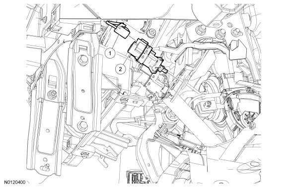

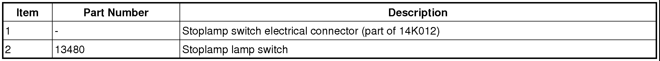

Here are the directions for replacing the switch. Pictures 3 and 4 correlate with these directions.
STOPLAMP SWITCH
Stoplamp Switch
Removal and Installation
NOTICE: Do not press, pull or otherwise move the brake pedal while installing the stoplamp switch and cruise control deactivation switch. Install these switches with the booster push rod attached to the brake pedal and with the brake pedal in the at-rest position. Installing these switches with the brake pedal in any other position results in incorrect adjustment and damages the switches.
1. NOTE: The stoplamp switch is located above the cruise control deactivation switch (if equipped).
Rotate the stoplamp switch clockwise approximately one-eighth turn to remove the stoplamp switch.
2. To install, reverse the removal procedure.
- Perform the brake pedal switch adjustment. For additional information, refer to Section 206-09

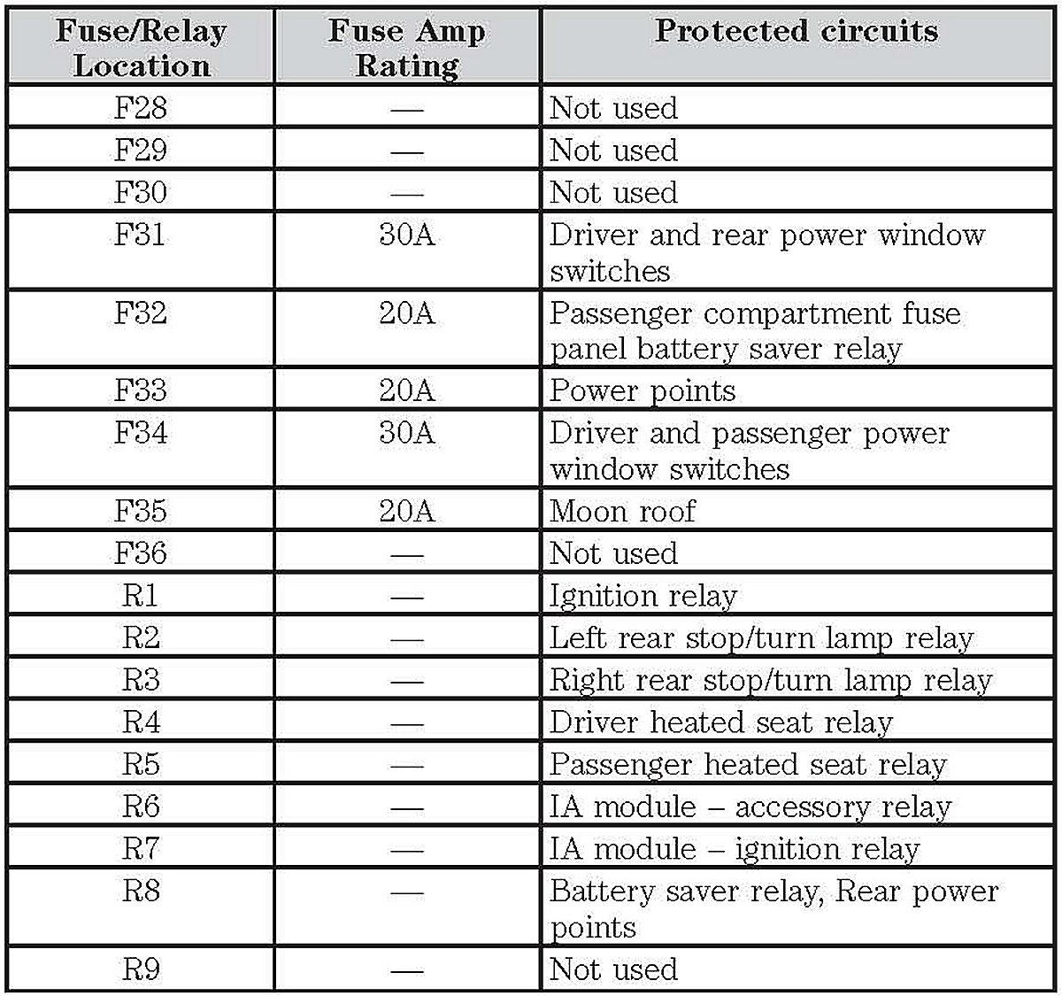

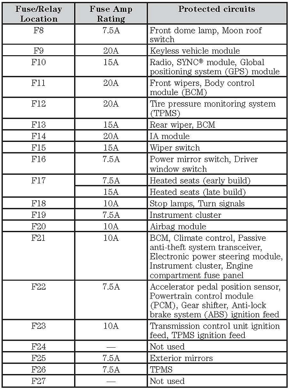

Last, the brake light fuse is located behind the glove box in the fuse box. Fuse F18 is for the brake lights. The last pictures are of the fuse box and its components. Check this first.
Let me know if this helps.
