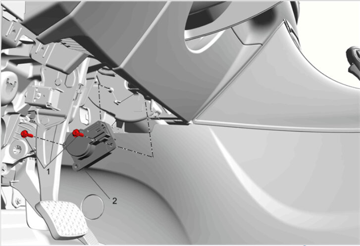

Cold air on passenger side hot on the driver side. Please advise.
Aug 20, 2025 at 12:34 PM
  • 54,832 POSTS
Yep, this is common when the driver side temperature blend door actuator goes out. Here is its location so you can swap it out. Here is how to reset the system after the repairs are done.
https://www.2carpros.com/articles/step-by-step-guide-to-reset-your-cars-hvac-system-an-essential-for-every
Check out the images (below). Let us know if you need anything else.

Where will the actuator be located on my 2017 invision
Aug 23, 2025 at 9:38 AM
  • 54,832 POSTS
Yes, you can move the blend door pivot to make sure the blend door inside the HVAC plenum works. The actuator in question location is in the images above.

The blend door on the drivers side in on the left above the gas pedal. Please upload an image of what you are having problems with so I can see.

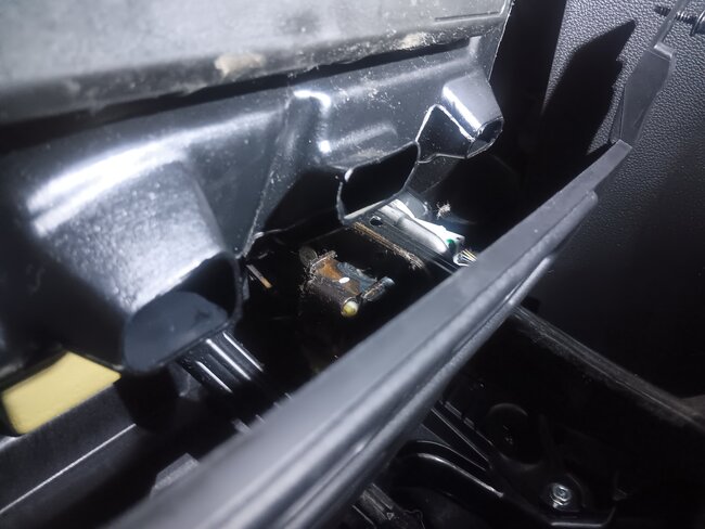

I'm just trying to get to the actuator to replace it.its above the heater vent
Aug 26, 2025 at 9:27 AM
PETER THE EATER
  • 24 POSTS
I can see it just can't access it

My car has climate control. Driver side hot passenger side coldish. Found the actuator on riverside and it seems ok because I could see the gear moving as I cycled the temp control. Do I need to get the system cleaned and recharged? Please advise.
