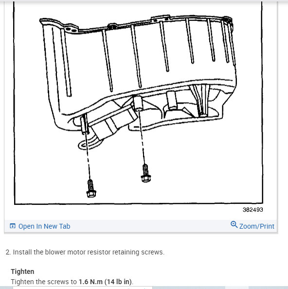

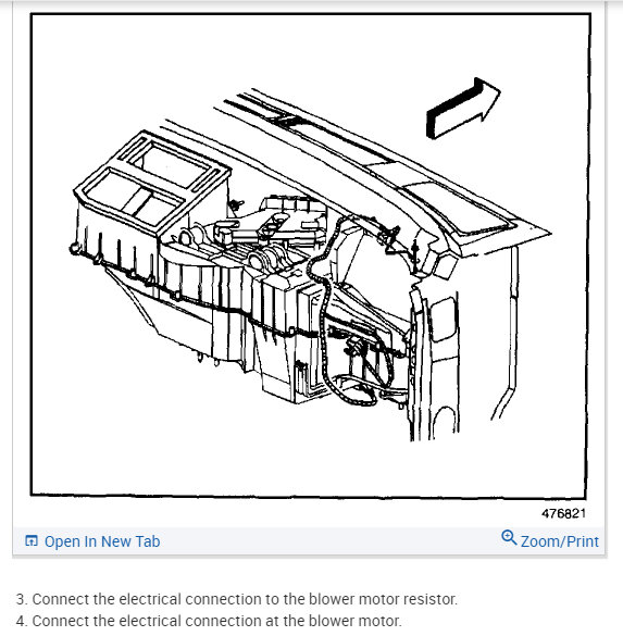

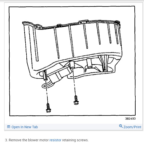

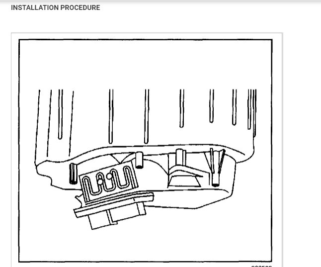

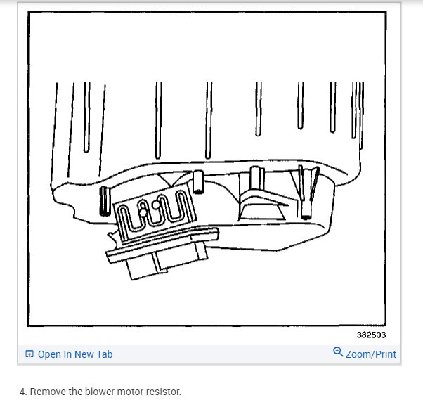

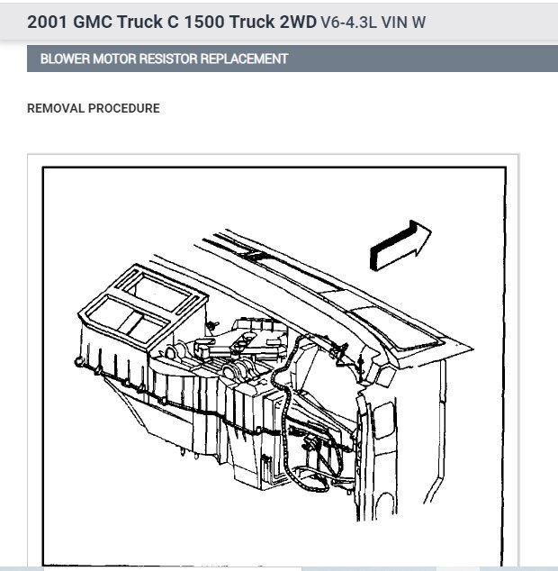

When you turn it on the only air that comes out is from the defrost vents and the only speed of air that works is 5 but it's barely blowing anything out.
Jun 8, 2023 at 3:10 AM
  • 110,248 POSTS
In most cases, when you only have the high-speed working, the blower motor resister has failed. However, that doesn't control airflow direction. That is controlled by the mode door actuator.
Let's focus on the blower motor speed. I attached the directions for replacing the blower motor resistor below. Do this and let me know if it resolves the fan speed issues.
