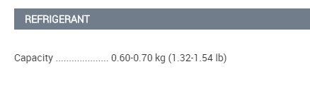

I put refurbished A/C pump, new condenser, new dryer, new hi low pressure switch, flush the system, put new expansion valve vacuumed system put 6 oz of oil in the A/C pump and still does not want take a charge. I bypass hi low pressure switch clutch engage and still does not want to take a charge. What am I doing wrong?

This could be the issue but I want to circle back and address when you said your low side is currently 85 PSI. If this is true, then your system is way to full. You will need to pull it back down into a vacuum and refill it. The low side should be around 30 PSI depending ambient temp. Take a look at the chart of pressures I attached.

Unfortunately they don't list this minimum amount to get the compressor to come on. They just say the switch will open if it is too low or too high.
Have you evac and recharged the system again and held a vacuum for 25 minutes? Then charge the system with the proper amount? How much did you put in last time?
