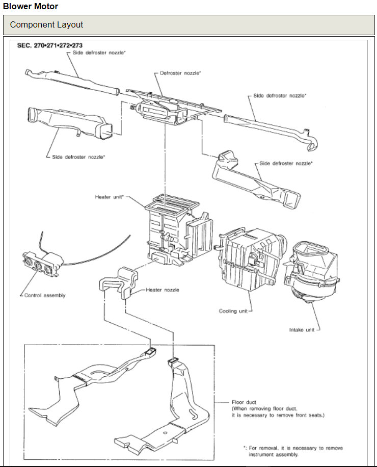

AC will not blow out of vents when truck is idle. Once I start down the road air starts coming out and the faster I go the more the air blows out and is very cold. Checked fuses and they are okay. Thought I heard a little drag when fan was running? Sort of like it was lightly hitting something.

It sounds like the blower motor is barley turning or not turning at all. Here is a guide to help you remove and test the blower motor:
https://www.2carpros.com/articles/blower-fan-motor-works-on-high-speed-only

Thanks! Had a new fan motor installed early Saturday morning.
