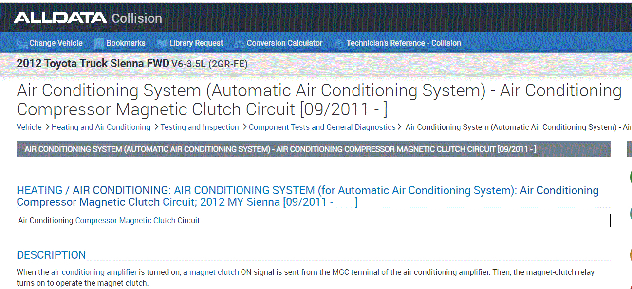

Fuses are good. System is correctly charged. When you first push the button the engine revs up and fans start but then it starts flashing again. Problem was intermittent now it constant.

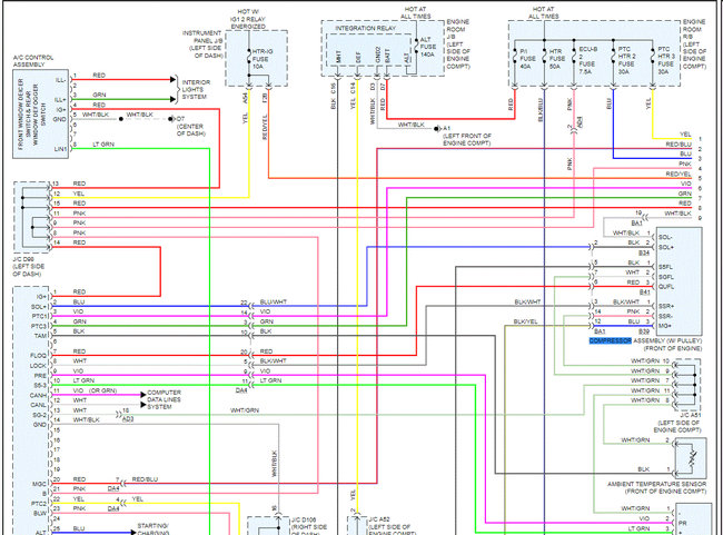

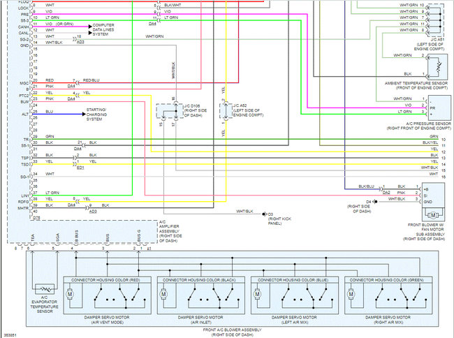

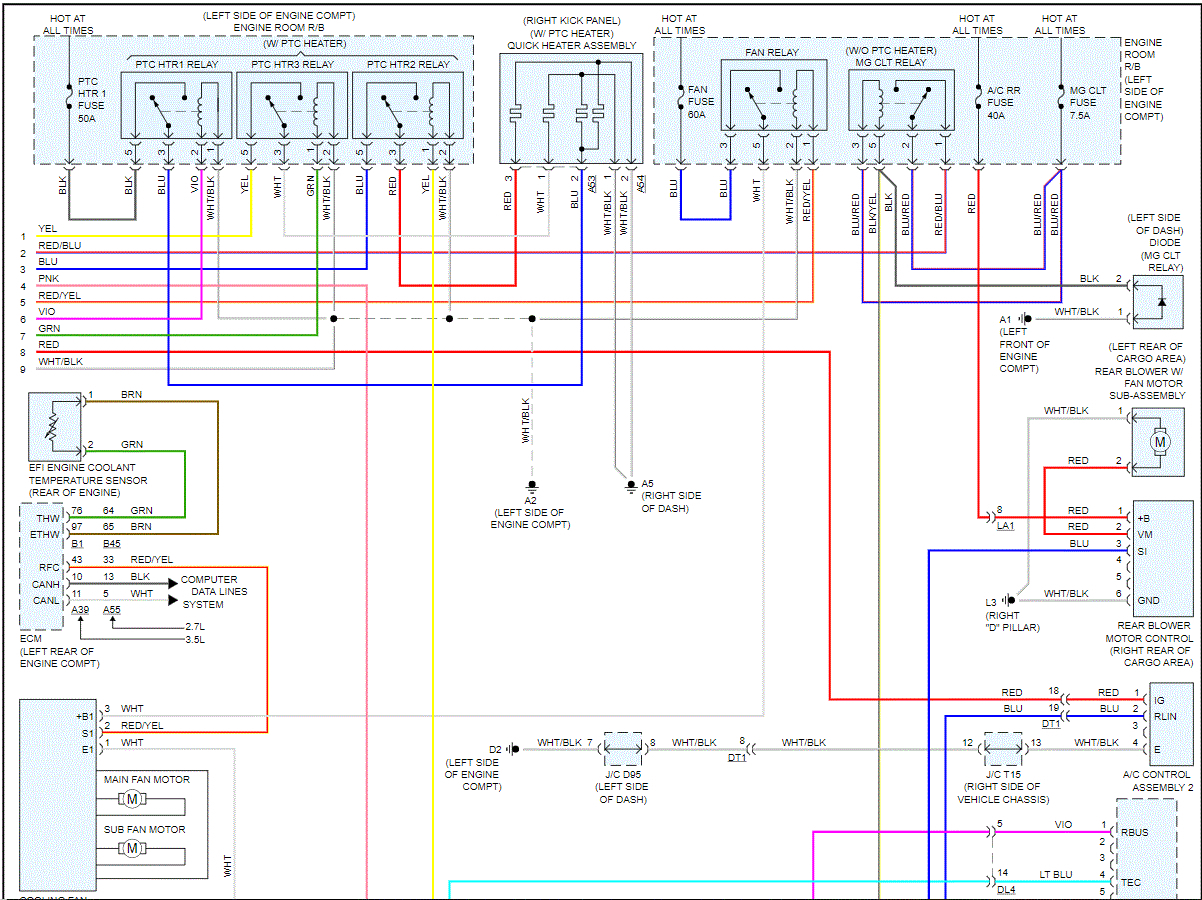

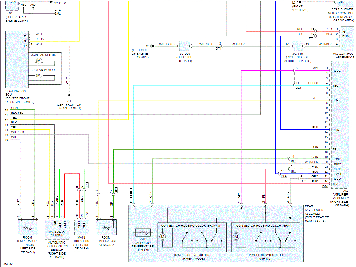

Does the compressor ever engage? If it doesn't, it could be a number of different things. First, I have to ask how the charge was checked. Also, if you could, let me know what both the high and low static pressures are and what the outside temperature was when checked.

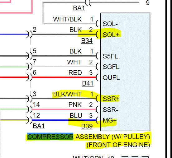

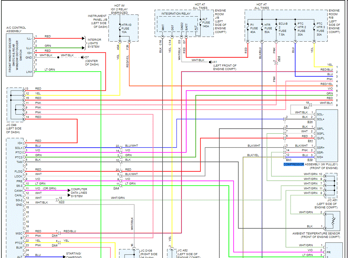

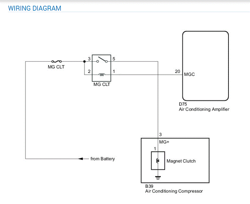

Next, if you are certain that all fuses are good, I need you to check for power at the compressor. If you look at pic 1 below, it shows the connection and which wires provide power. Make sure each of the wires have power when the system is on. Here is a link you may find helpful:

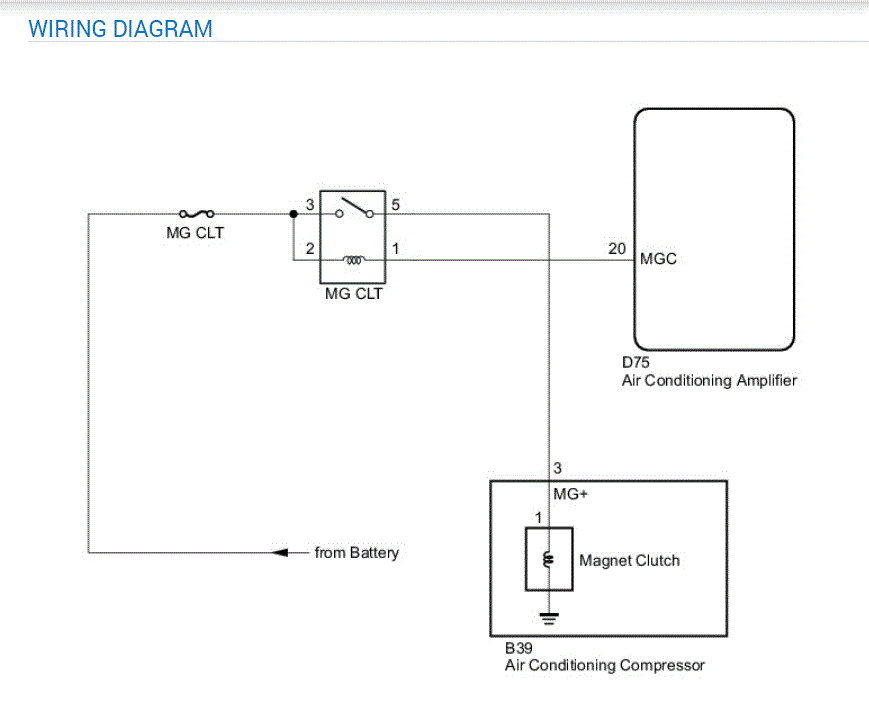

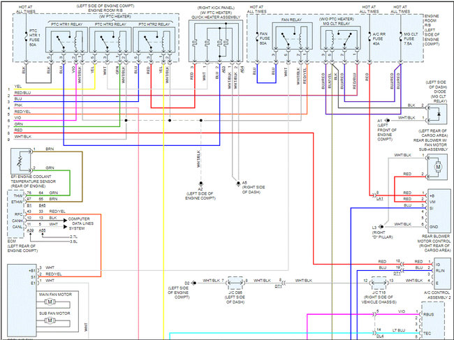

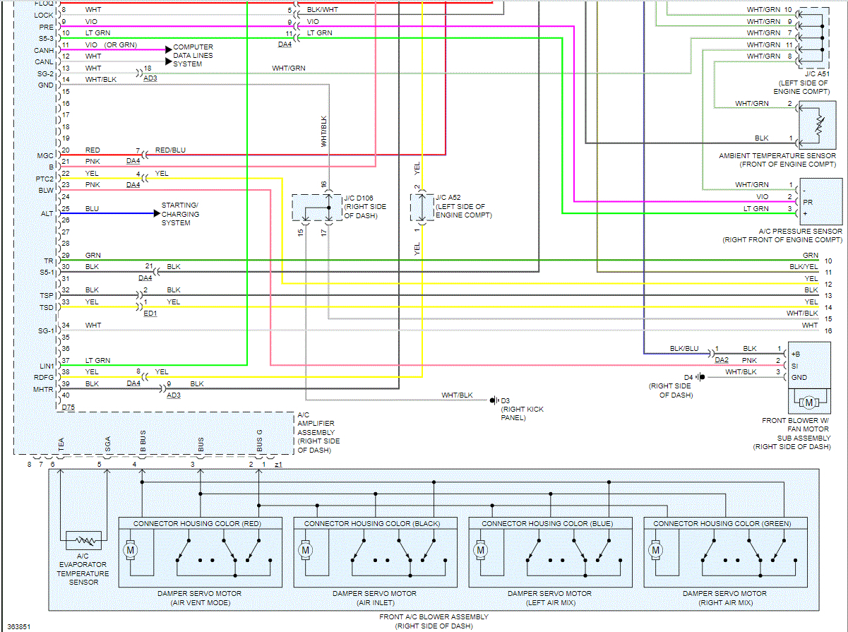

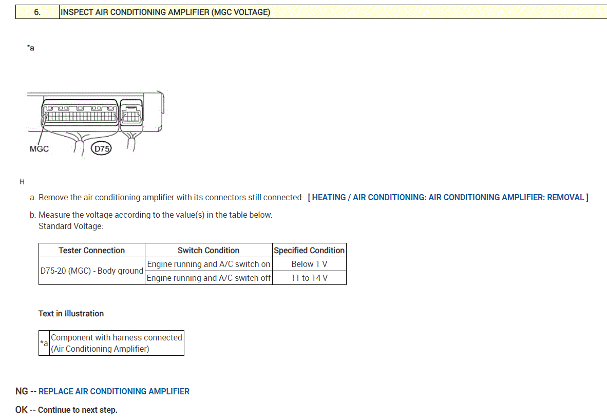

The remaining pics provide the entire wiring schematic related to the AC/HVAC system. I'm adding them in the event you need to reference something.
Note: Starting with pic 2 below, I had to cut the schematic pages in half to make them readable for you. I did overlap them so you can follow from one to the other.

When you get the chance, check for power to the compressor clutch. If it has power, replace the clutch. If there is no power, then we need to confirm there is enough gas in the system for the low pressure to allow the system to operate.

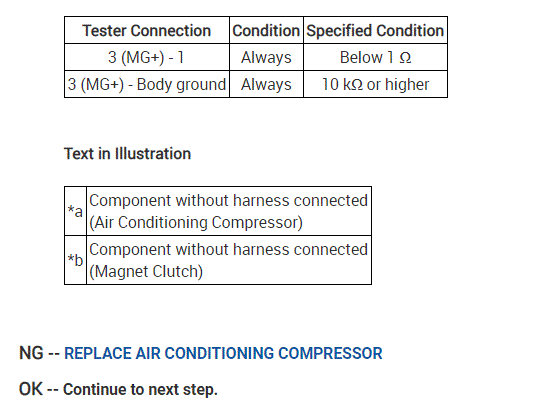

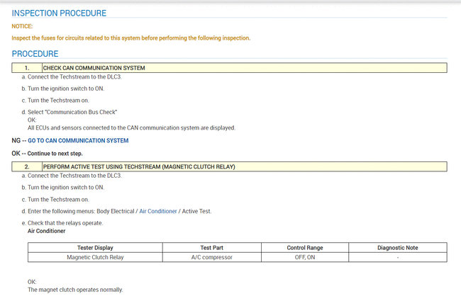

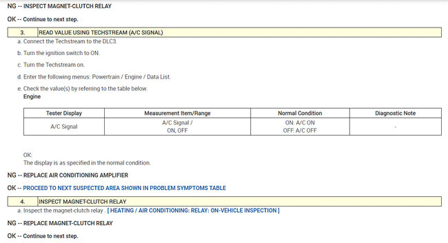

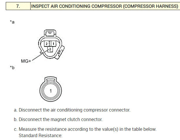

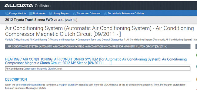

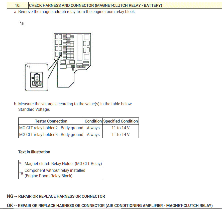

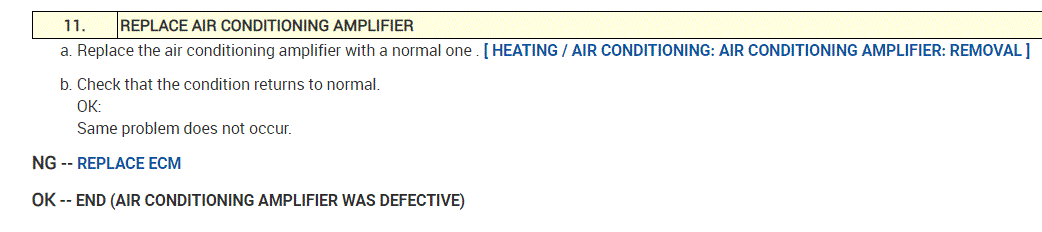

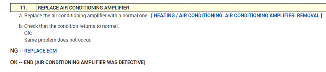

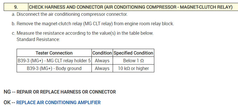

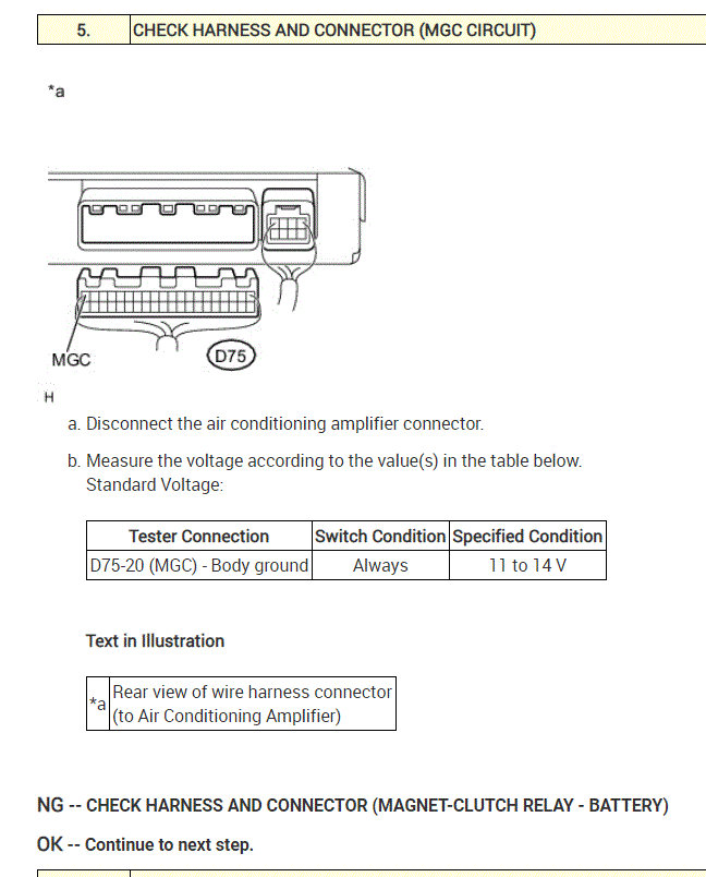

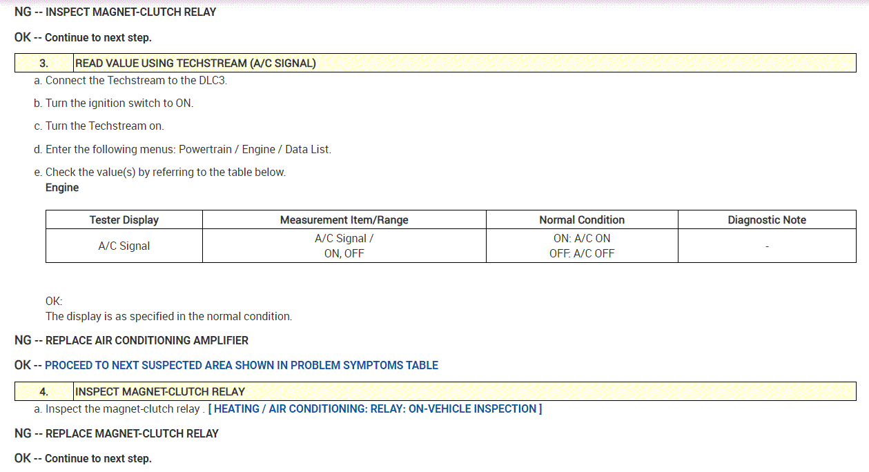

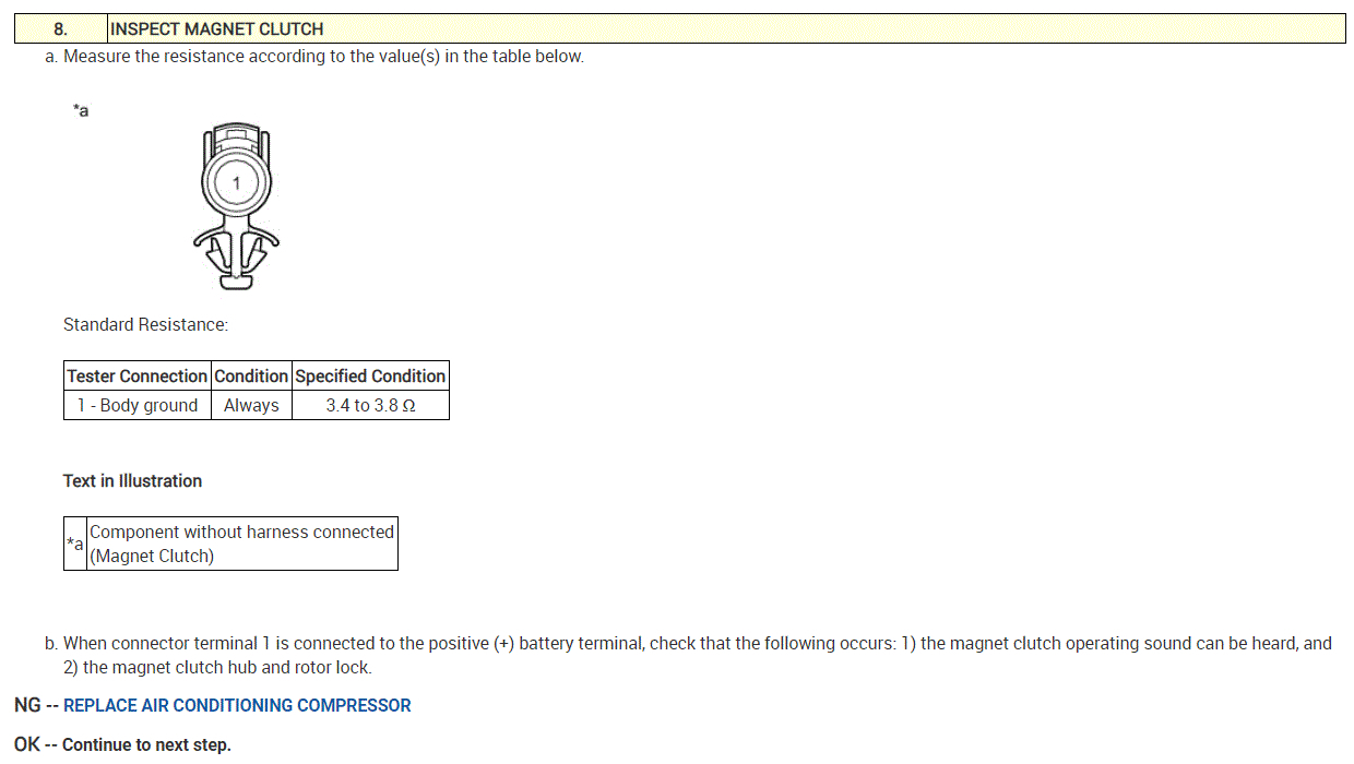

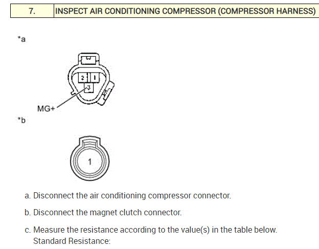

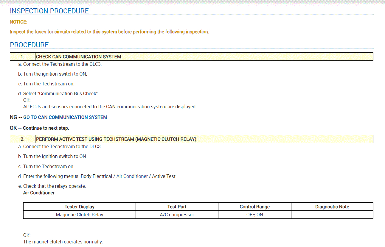

What to do is when it fails, check to see if there is still power to the A/C clutch. Also, if you look below, I included the diagnostics for the system. If you jump to step 8, it shows how to check the compressor clutch itself.
