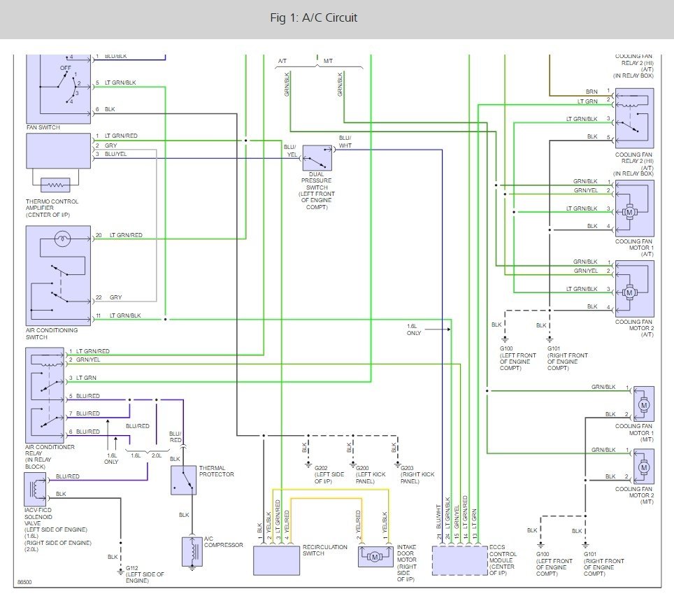

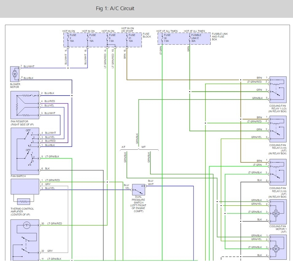

Hi, A/C compressor is not activated when l turn on A/C button. A/C button has three pins and only has power. relay and all fuses are okay.
May 28, 2017 at 5:12 AM
Experienced Mechanic
55,649 POSTS
First make sure the system has a good charge which you can do by following this link.
https://www.2carpros.com/articles/air-conditioner-how-to-add-freon
Next here is a wiring diagram (BELOW) and a guide so you can do some testing. As you can see by the diagram there are many fuses that run the system.
and
Please run some tests and get back to us so we can continue helping you.

I found the problem, the connector of temp sensor was disconected...a banal error- Thank you for your time.
