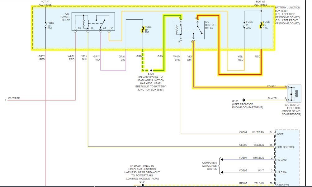

The fan blows in the car but it’s hot air. I tried to add Freon but it acted like it wasn’t taking the Freon. How do I know if the compressor is working properly or if it just needs recharged?
May 7, 2019 at 6:50 AM
Good afternoon,
You can tell if you see the compressor clutch engaged when you turn on the AC.
Can you give me the high and low side pressures?

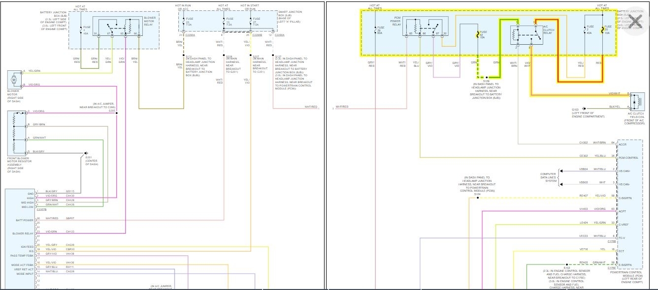

I attached a wire diagram for you to view. Check the fuses listed for power on both sides.
