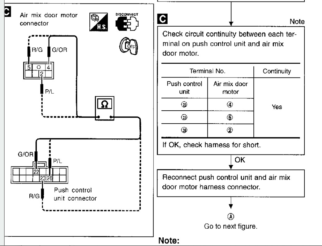

Sorry, we have no pictures of location of air mix. You contradict yourself by one person saying compressor other says air mix. Here is how to test if air mix gets power. See image.

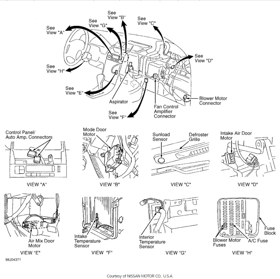

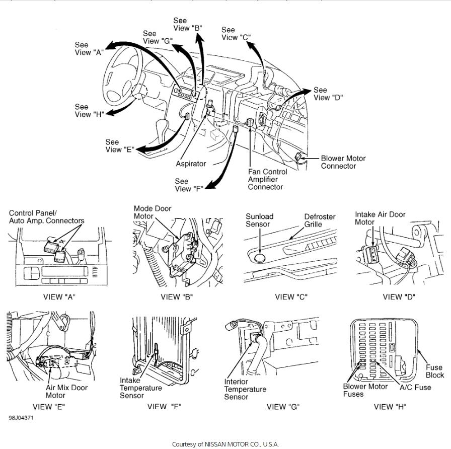

Here is a picture of the blend door locations.
Let us know what you find.
Best, Ken
