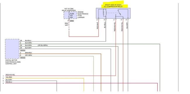

Where is my AC relay location?
Aug 27, 2018 at 12:07 PM
AL514
  • 5,481 POSTS
Hello there and thanks for using 2CarPros.com. Here is a wiring diagram of the A/C compressor relay located under the right side of the dashboard, assuming that is what you are looking for. Hope this helps. You can locate it by looking for the correct wire colors on the diagram.
