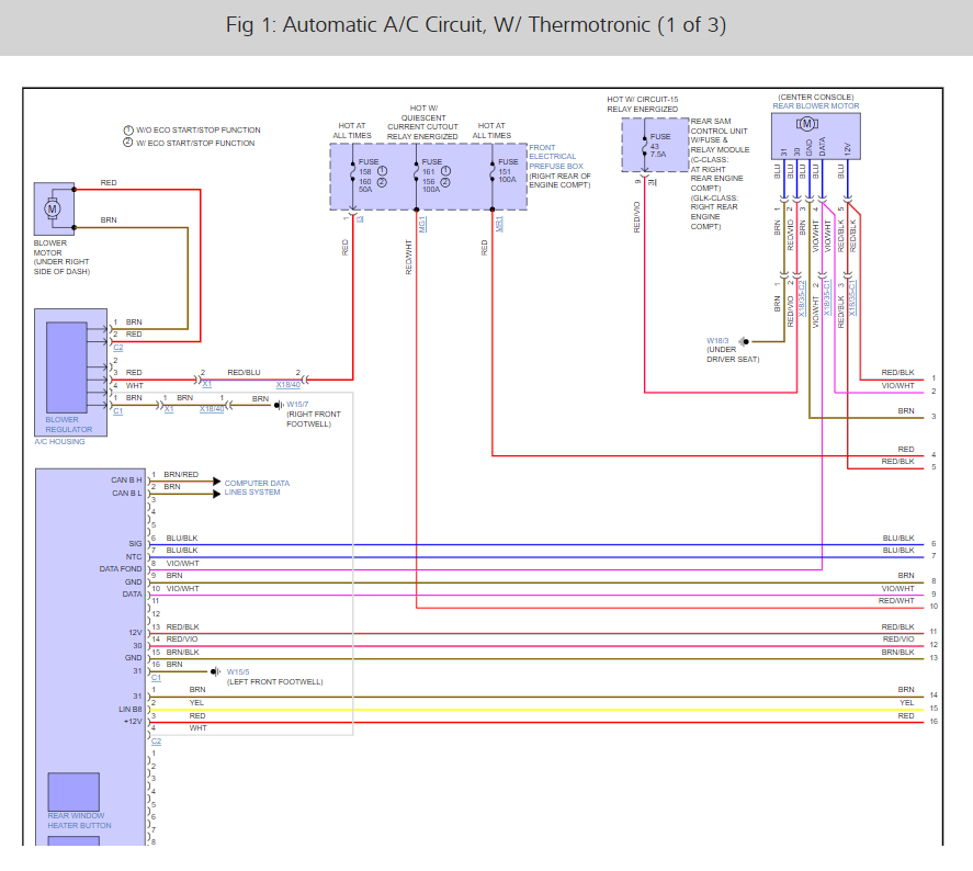

A/C compressor only engages in the morning
2013 MERCEDES BENZ C350
100,000 MILES • 3.5L • 6 CYL • 2WD • AUTOMATIC
CARLTON1

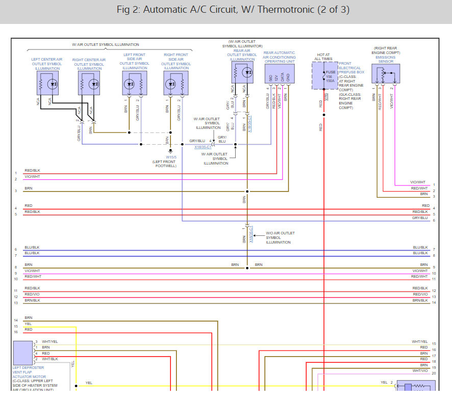

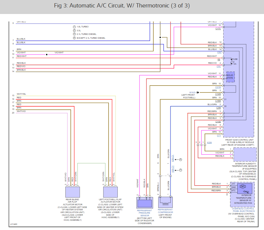

The compressor will engage in the morning and A/C will work perfectly. After the car is turned off the A/C compressor will not engage again.
Apr 5, 2022 at 9:10 AM
  • 55,399 POSTS

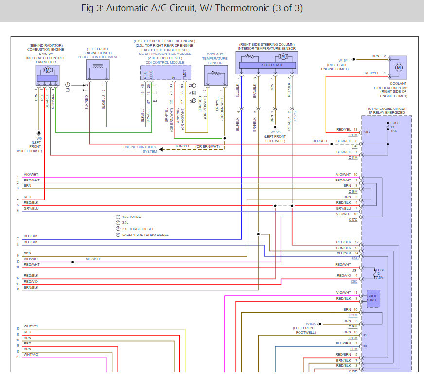

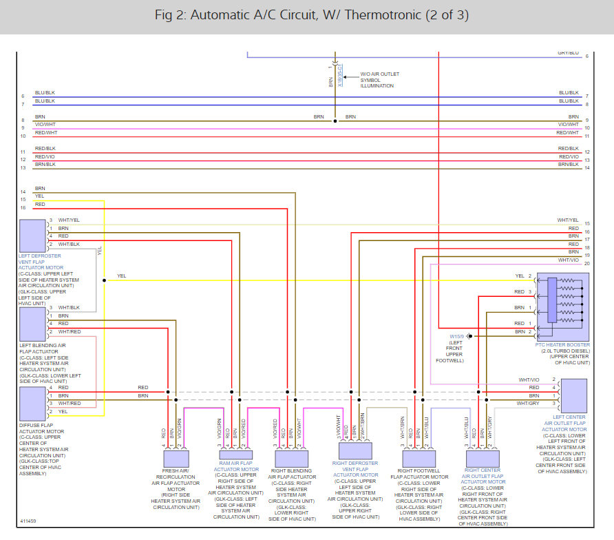

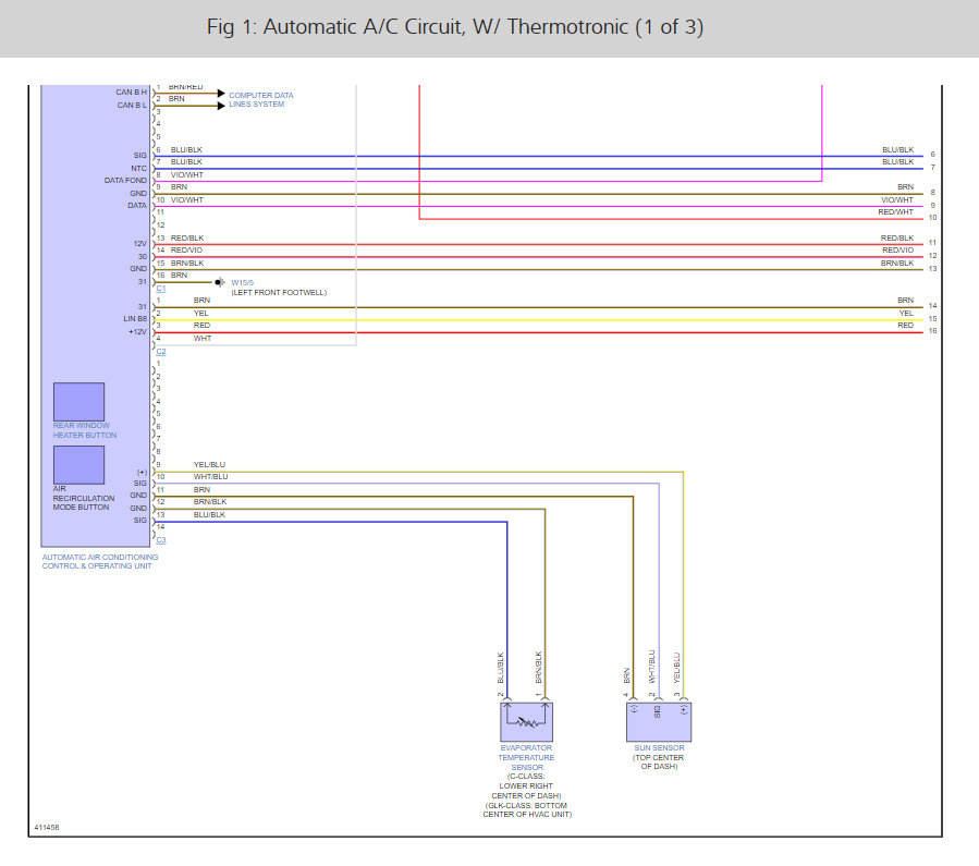

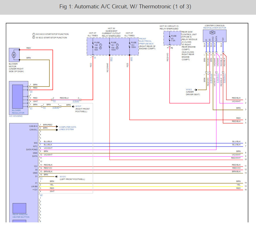

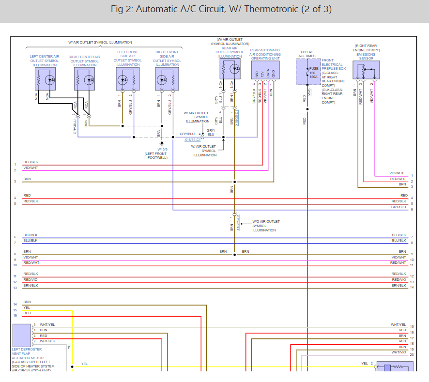

I have seen the front sam control module heat up and go out causing this issue but to be sure let's do a CAN scan which goes through the entire car and shows any faults with the HVAC system. The scan is easy to do check out this guide and video. Also, I have included the A/C wiring diagrams so you can see how the system works.
